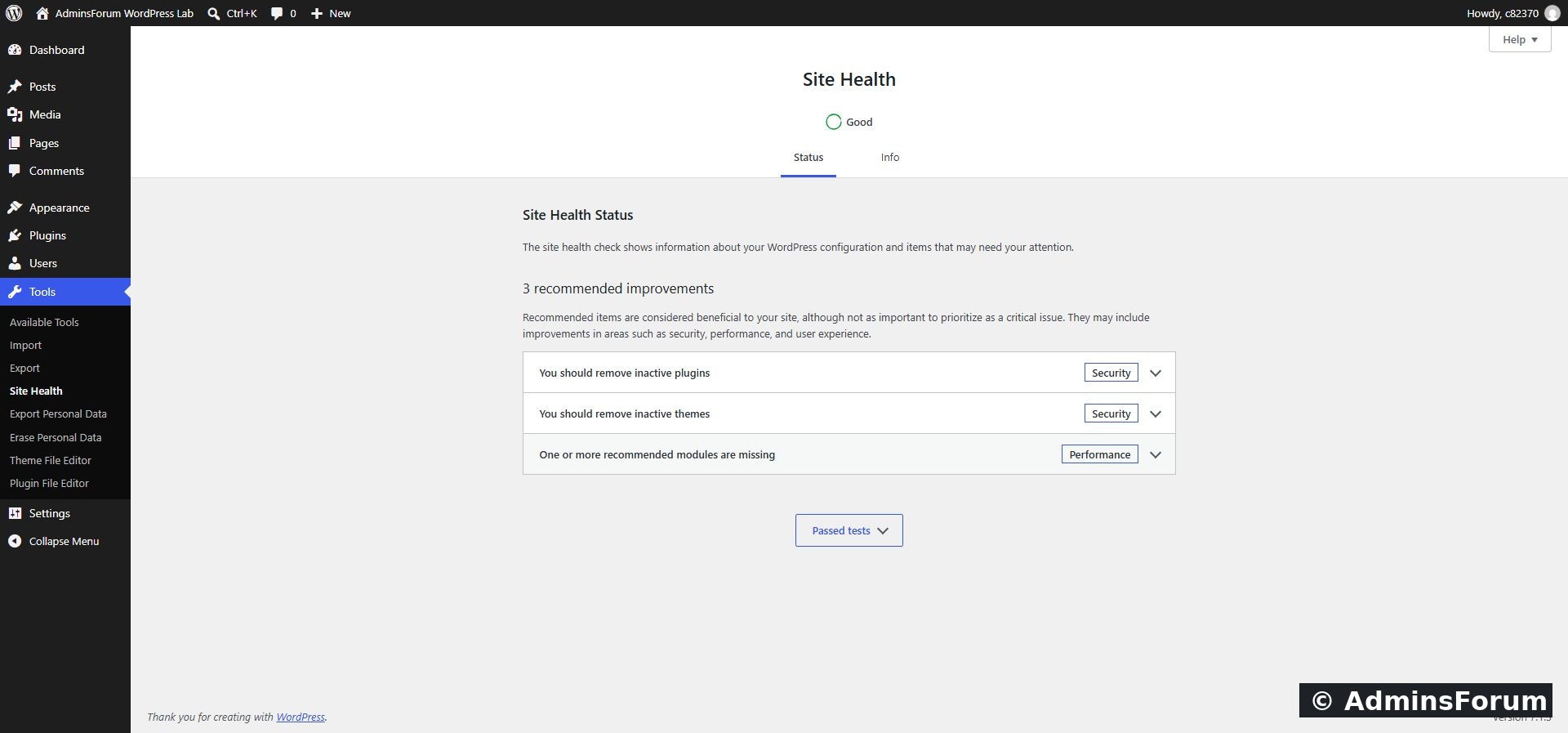

1. Confirm the WordPress warning
Open WordPress → Tools → Site Health, let the checks finish and expand the missing-module recommendation. After our earlier EXIF installation, the remaining optional-module warning named imagick.
The remaining Imagick warning before installation.
Optional-module advice is different from a fatal website error. Install the extension for a clear requirement and verify it afterward; do not assume every warning needs a broad server reconfiguration.

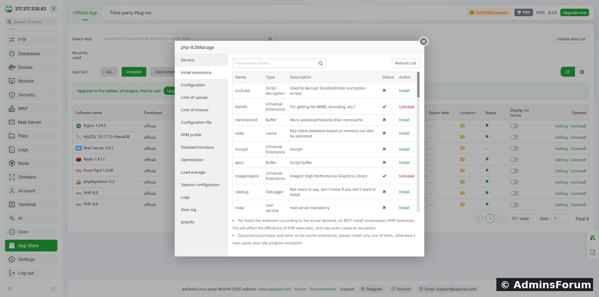

3. Install the matching extension
In aaPanel select App Store → Installed. Find PHP-8.5 for this example and choose Setting. Open Install extensions.
Locate imagemagick, described in our list as Imagick High Performance Graphics Library. Click Install in that row and confirm Install【imagemagick】 after checking the PHP version and extension name.
The row displayed Installing while the job ran. Compilation takes time; do not submit duplicate installs or judge success from a pending status. Read the installation task/log if it fails or stops progressing.
4. Confirm the installed state
After the job finished, we reopened the PHP manager and extension list. The imagemagick row offered Uninstall, showing that the installed module was recognised by the panel.
The refreshed PHP 8.5 extension list after installation.
If a refresh briefly leaves the table blank, reopen the manager after the task has completed. Do not treat an empty table as proof of either success or failure.

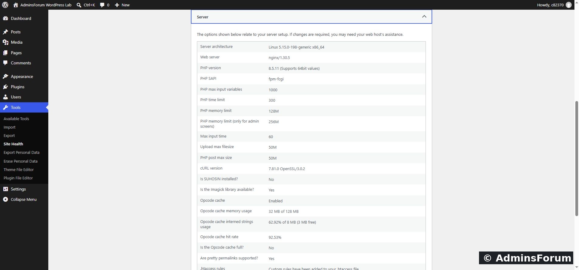

5. Verify WordPress uses it
Return to WordPress Site Health and let the checks complete. In our test, the missing-module recommendation disappeared. We then opened Info → Server and checked Is the Imagick library available?. It reported Yes.
WordPress’s own runtime reports that Imagick is available on PHP 8.5.11.
A command-line check alone is not enough if CLI and the website use different PHP configurations. WordPress’s result confirms availability to the website. Our remaining recommendations concerned inactive plugins/themes; this installation does not claim to fix unrelated maintenance findings.

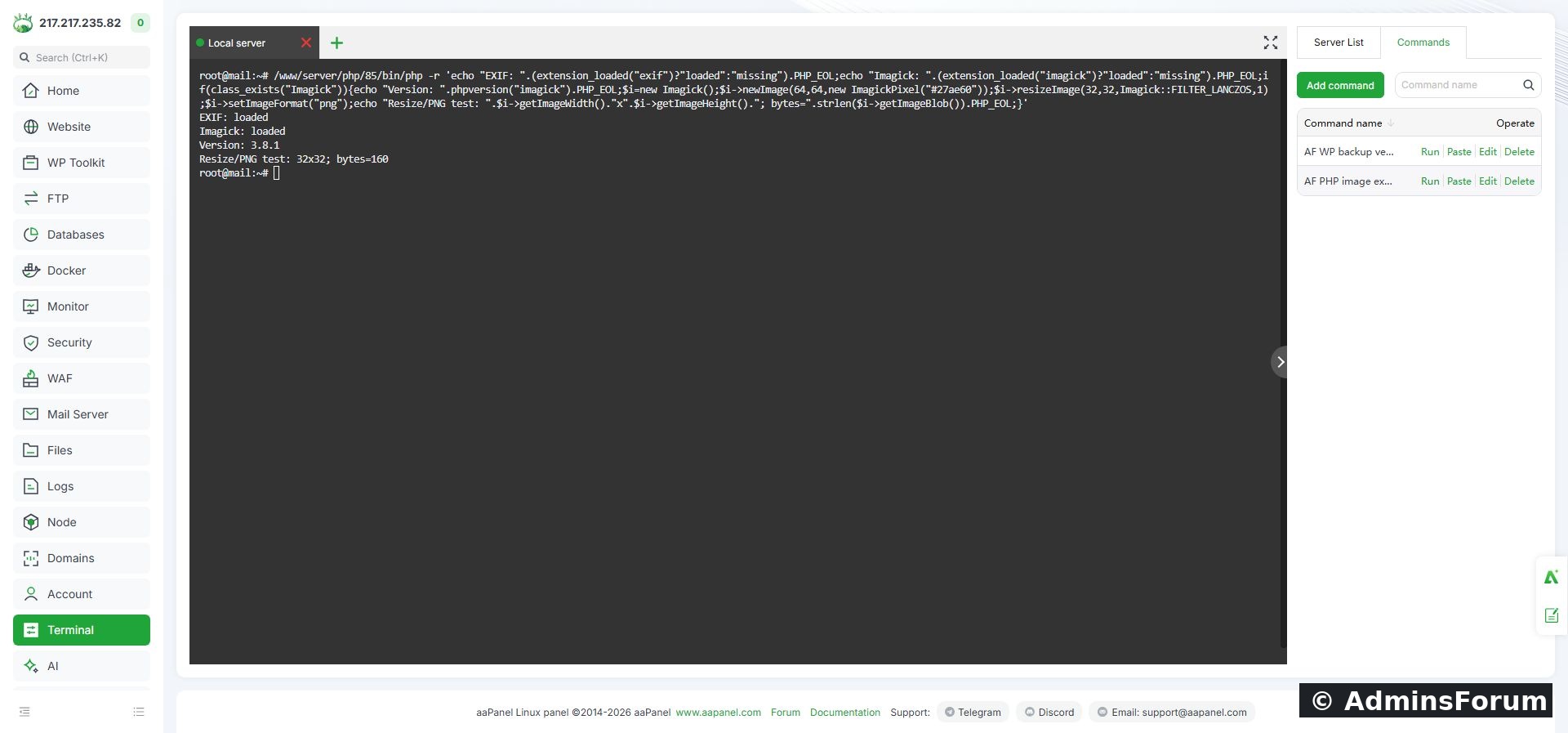

6. Verify a basic image operation
We also ran a small private command-line test with the exact aaPanel PHP binary. It reported EXIF loaded, Imagick loaded and extension version 3.8.1. It created and resized a test image, then produced a non-empty PNG blob.
Our functional test returned 32 × 32 pixels and 160 PNG bytes.
For administrators who want a basic version-specific availability check:
/www/server/php/85/bin/php -r 'echo extension_loaded("imagick") ? "Imagick loaded " : "Imagick missing ";'
Use the correct path for your installed PHP version. The test was performed privately in the terminal; we did not leave a public phpinfo or diagnostic script on the website.
A small PNG test does not prove that every image type, large upload, PDF delegate or animation workflow works. Verify the formats and operations your application actually needs.
