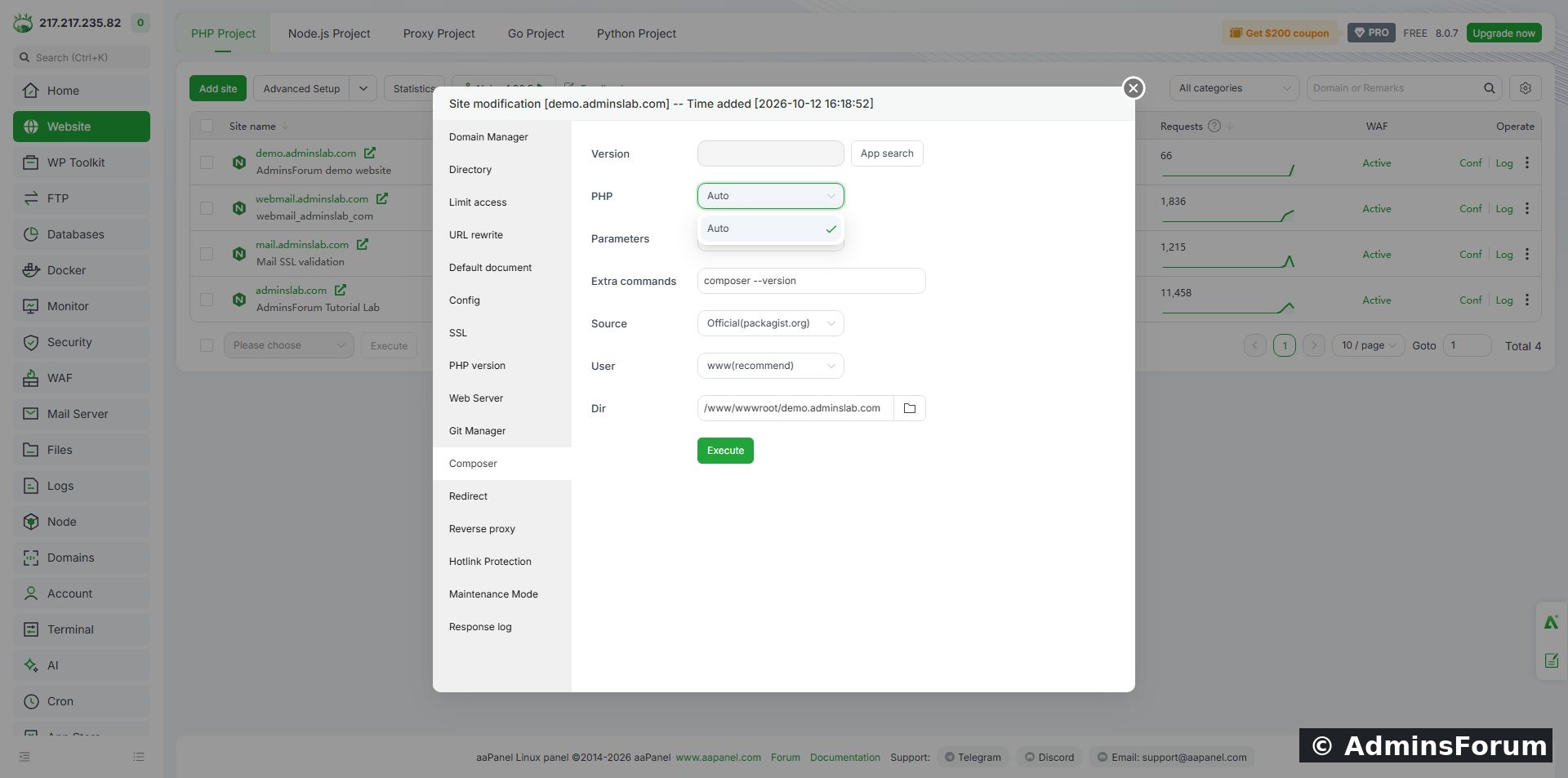

In aaPanel open Website → Conf → Composer. Our interface exposes PHP, command parameters, source, execution user and directory controls. Its version field was blank and the PHP selector offered Auto. Submitting composer --version returned Command has been sent! without command output in this screen.
Inspected Composer controls. This screenshot does not prove that the submitted command completed.

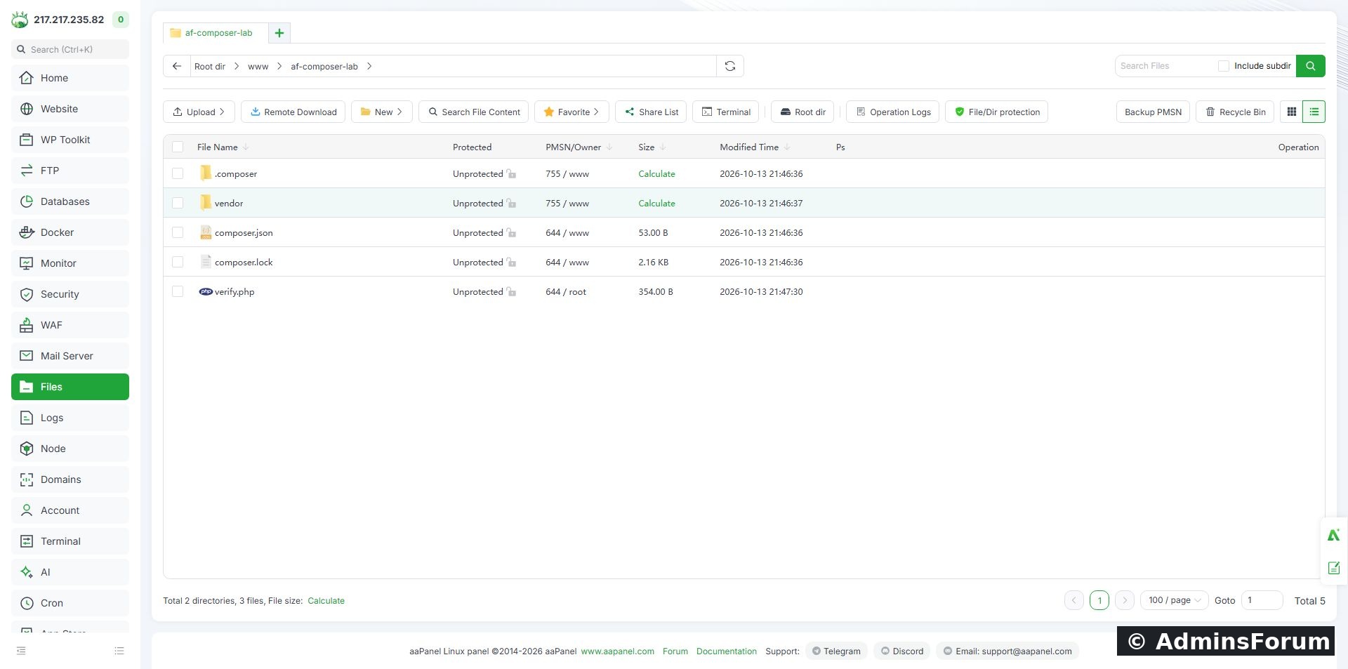

runuser -u www -- env COMPOSER_HOME=/www/af-composer-lab/.composer /www/server/php/85/bin/php /usr/bin/composer --working-dir=/www/af-composer-lab require 'psr/log:^3.0' --no-scripts --no-plugins --prefer-dist --no-interactionThe actual output created composer.json, locked psr/log at 3.0.2, extracted the package and generated autoload files. aaPanel File Manager then showed composer.json, composer.lock and vendor with www ownership.
Actual files produced in the isolated project directory. verify.php was our additional CLI-only test file.

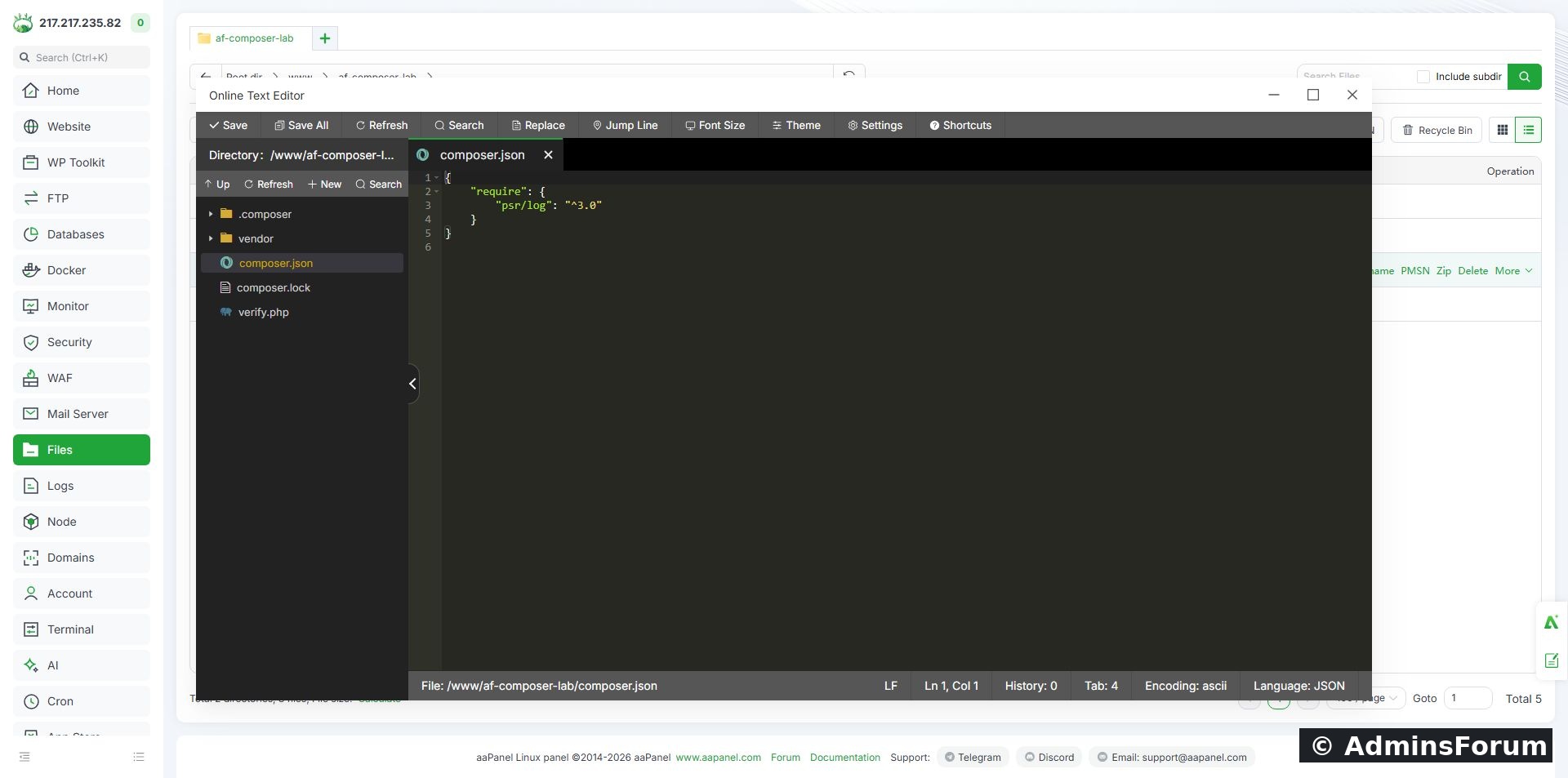

Open composer.json in File Manager to inspect it without changing anything. Our generated manifest contains psr/log with the ^3.0 requirement.
The generated dependency requirement. composer.lock records the resolved version separately.
