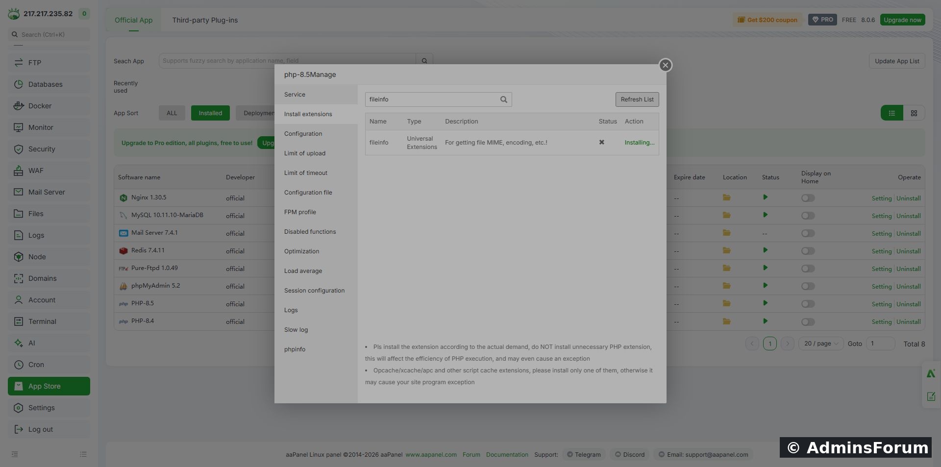

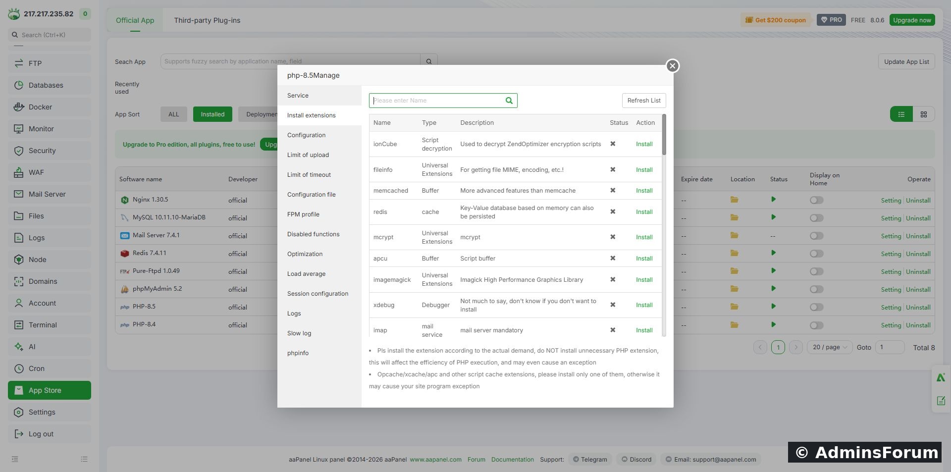

Go to App Store and choose Installed. Find the correct PHP row, click Setting, then choose Install extensions in the PHP manager's left-hand menu. Locate fileinfo in the table; you can use the extension search field when available.
AdminsForum lab: the extension manager before installation. Locate the fileinfo row and its Install action.

Click Install on the fileinfo row and confirm the prompt. aaPanel adds the job to its installer queue. Leave the job running rather than submitting it repeatedly. Compilation can take several minutes, depending on the server and downloads.
An Installing status means the job is still in progress; it is not a successful completion result. If the job fails, read the installation log and retain the exact error for troubleshooting.

After the installer finishes, use Refresh List. On our lab, fileinfo showed Uninstall, which indicated it was installed for this PHP version.
AdminsForum lab: fileinfo now has an Uninstall action. The runtime test below also confirmed it was actually loaded.
