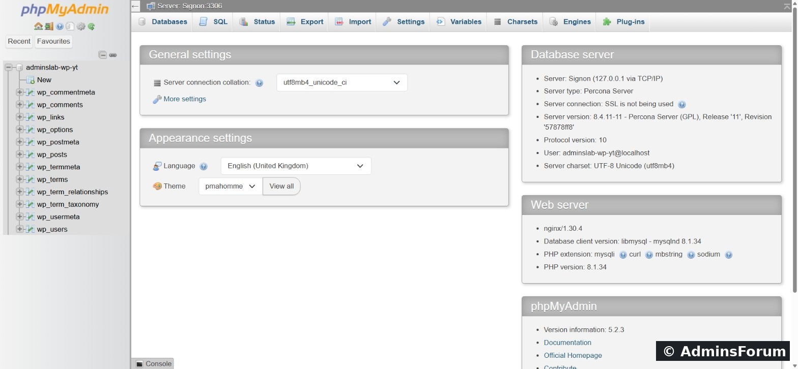

  • phpMyAdmin opened from the panel and showed the new version:
