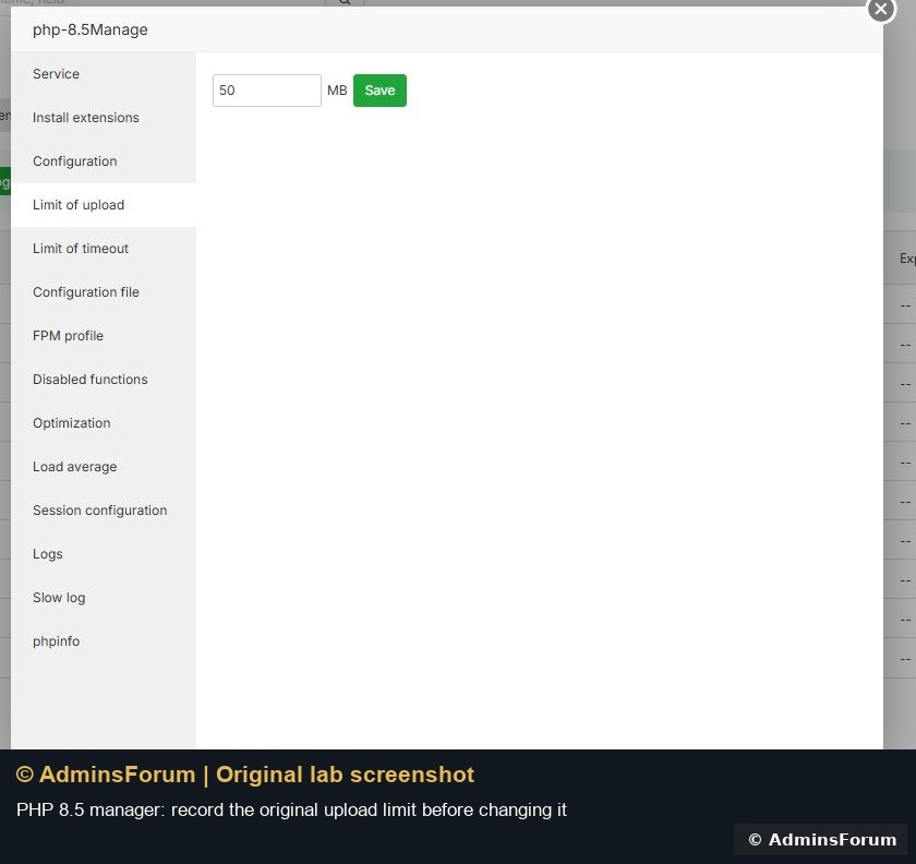

Open App Store → Installed → PHP-8.5 → Setting. Choose Limit of upload. The lab originally showed 50 MB. WordPress Media → Add Media File also reported 50 MB.
batch11 php limit before branded
For your site, use its actual version rather than following the number in our example blindly. Choose a limit appropriate to the files and server resources you need.

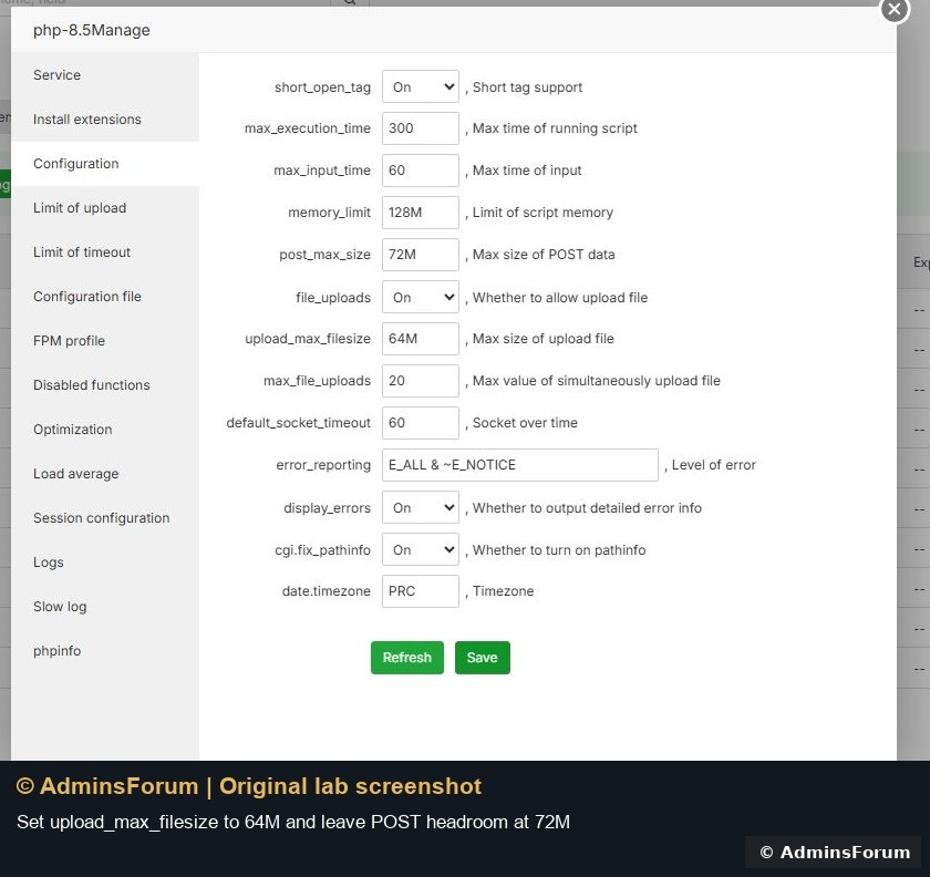

On Limit of upload, enter 64 and click Save. Wait for completion. Then open Configuration and review upload_max_filesize and post_max_size. Our panel's upload-limit action set both to 64M; we changed post_max_size to 72M and saved again.
batch11 php limit config branded
The file limit applies to one uploaded file. POST size applies to the complete request, including form fields and upload overhead. Keep POST size above the intended file size. Our resulting settings were:
upload_max_filesize = 64M post_max_size = 72M memory_limit = 128M
These are tested example values, not a universal tuning preset. A large high-resolution image may require much more processing memory than its compressed file size suggests.

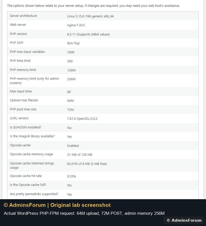

Refresh Tools → Site Health → Info → Server. Our website reported upload_max_filesize 64M, post_max_size 72M, frontend memory 128M and administration memory 256M.
batch11 php limit runtime branded

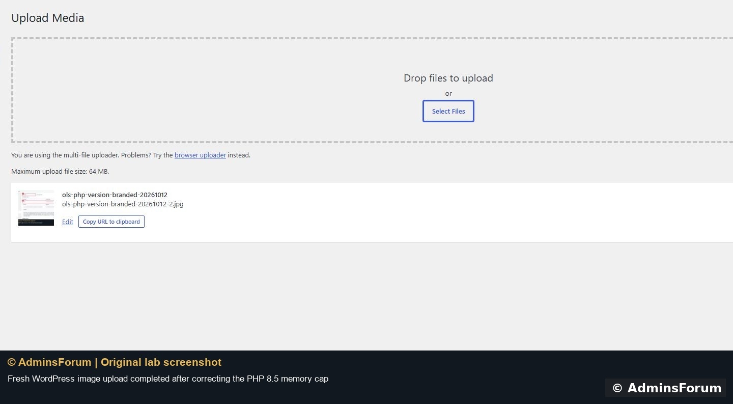

Then reopen Media → Add Media File. WordPress showed Maximum upload file size: 64 MB. We uploaded a fresh original branded JPEG successfully; the upload finished and offered Edit and Copy URL actions without the earlier memory warning.
batch11 php upload pass branded
We verified the settings and a normal image upload. We did not test a file exactly at the 64 MB boundary, so this post does not claim a maximum-size stress test.
