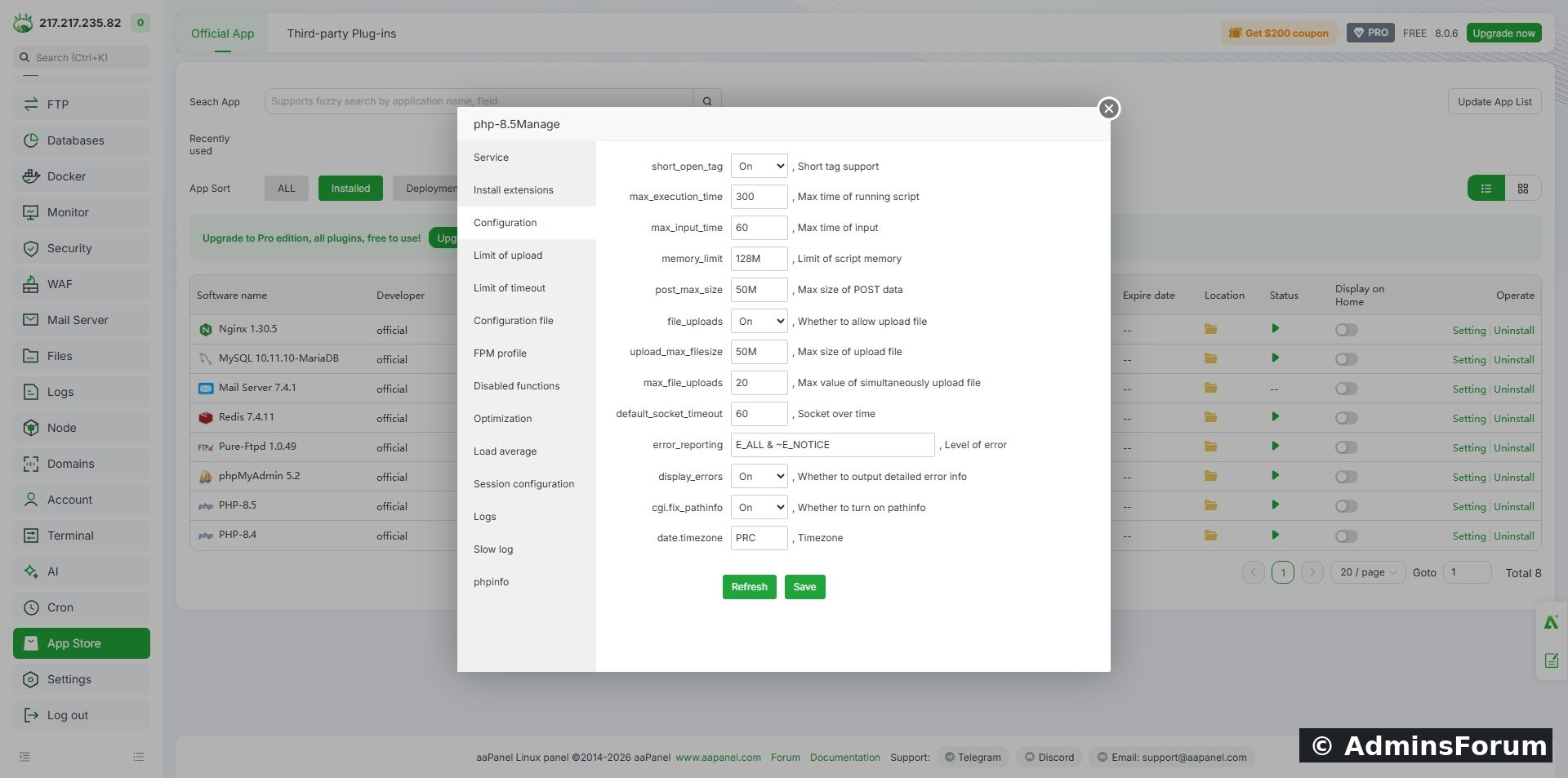

2. Open the PHP configuration screen
Open App Store → Installed. Find the matching PHP row and click Setting. Choose Configuration in the left-hand menu.
![[Image: php-configuration-20261011.png?v=copyright1]](https://adminsforum.com/images/tutorials/php-configuration-20261011.png?v=copyright1)
AdminsForum lab: PHP 8.5 Configuration. The pictured values are the lab's current values, not a recommended configuration for every website.
3. Understand the three limits
4. Enter and save the values
In Configuration, edit the relevant text boxes. Keep the M suffix where a value is expressed in megabytes. Check that file_uploads is On if the application requires uploads. Click Save and read the resulting status message. Do not change unrelated settings while diagnosing one problem.

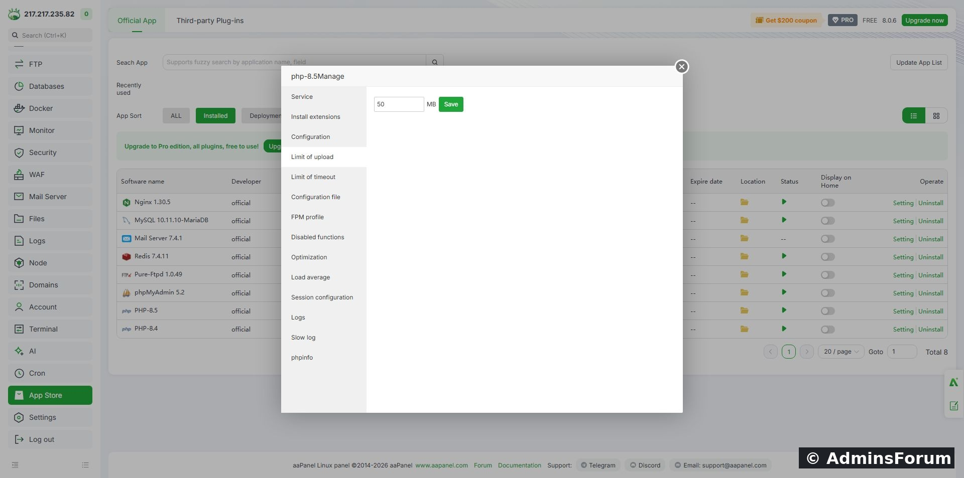

The separate Limit of upload screen offers one size field in MB:
![[Image: php-upload-limit-20261011.png?v=copyright1]](https://adminsforum.com/images/tutorials/php-upload-limit-20261011.png?v=copyright1)
AdminsForum lab: the Limit of upload shortcut currently shows 50 MB.
If you use that shortcut, return to Configuration afterward and inspect both upload_max_filesize and post_max_size. The Configuration screen makes the individual settings easier to review. Do not assume one shortcut also adjusts memory, application limits or Nginx.
- upload_max_filesize limits a single uploaded file.
- post_max_size limits the entire POST request, including files and other form data. Allow room beyond one file's limit, especially for multiple files.
- memory_limit limits memory used by a PHP script. Upload size and script memory are different: processing an image or import may require considerably more memory than the file size.
