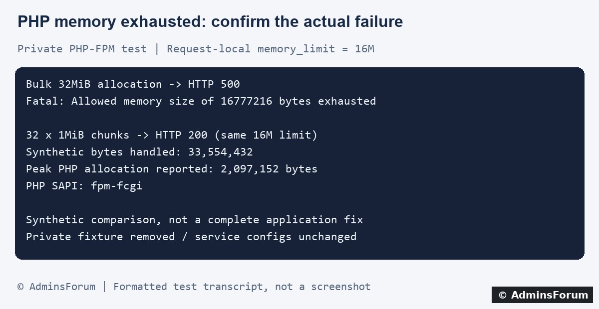

Original AdminsForum private lab evidence, formatted as a transcript rather than a screenshot.

Our isolated PHP-FPM request produced:
The allowed amount was 16 MiB. The attempted allocation is the size of a particular allocation attempt, not the application's total memory requirement. Do not add the two numbers and assume that is a reliable production setting.

3. What our private PHP-FPM test showed
We used a harmless PHP fixture outside the public website root and a separate loopback-only Nginx endpoint. The script applied and checked a request-local 16M memory limit; no shared php.ini or PHP-FPM pool setting was changed.
The PHP fixture was removed, the private listener stopped and its PID file disappeared. Hash checks confirmed the main Nginx configuration, PHP-FPM pool configuration and php.ini were unchanged. The normal HTTPS site returned 200 afterward.
- A bulk attempt to create a 32 MiB string returned HTTP 500. The private Nginx error log captured the PHP memory fatal error.
- A second request created and discarded thirty-two 1 MiB strings, one at a time. It counted 33,554,432 synthetic bytes and returned HTTP 200 under the same 16M limit.
- The successful request identified its SAPI as fpm-fcgi and reported a peak PHP allocation of 2,097,152 bytes. No new matching memory fatal appeared after it.
