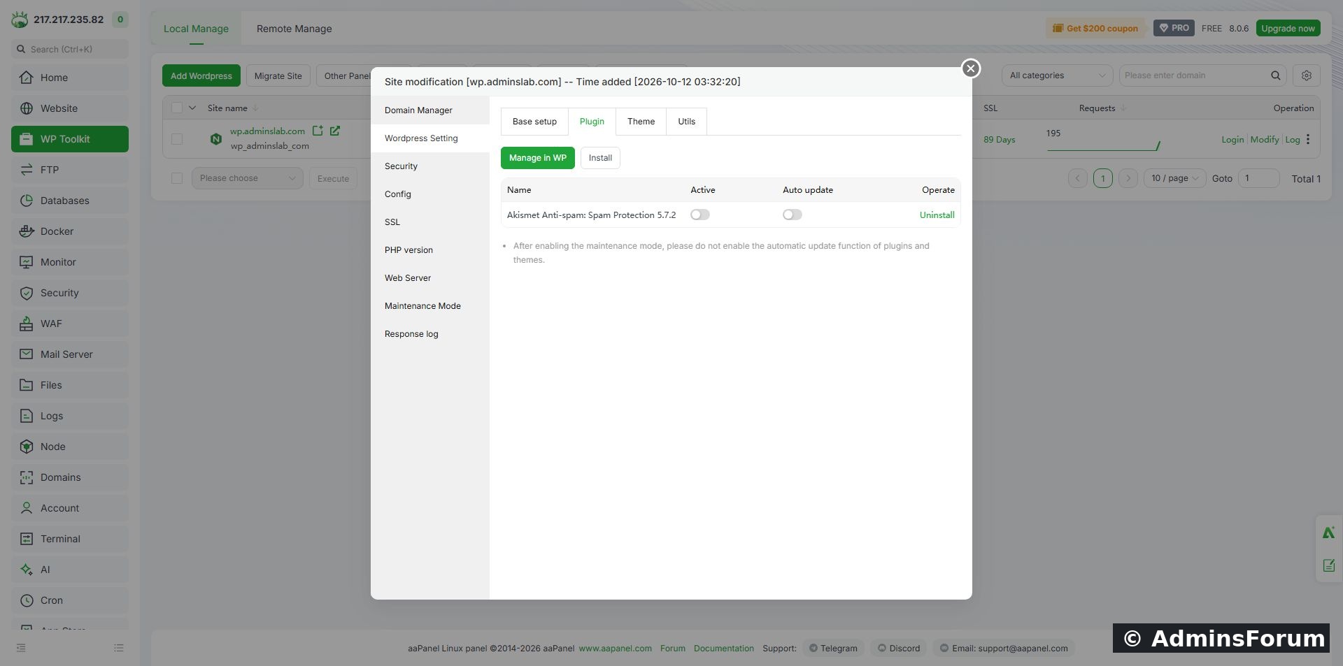

In aaPanel’s left menu choose WP Toolkit. Locate your domain. In the Quick action area, click its WordPress version button. Our button displayed 7.1.3; yours may show a different version.
The Site modification window opens with Wordpress Setting selected. Choose the Plugin tab alongside Base setup, Theme and Utils.
The Plugin tab before our installation. Existing plugins have separate Active and Auto update switches.

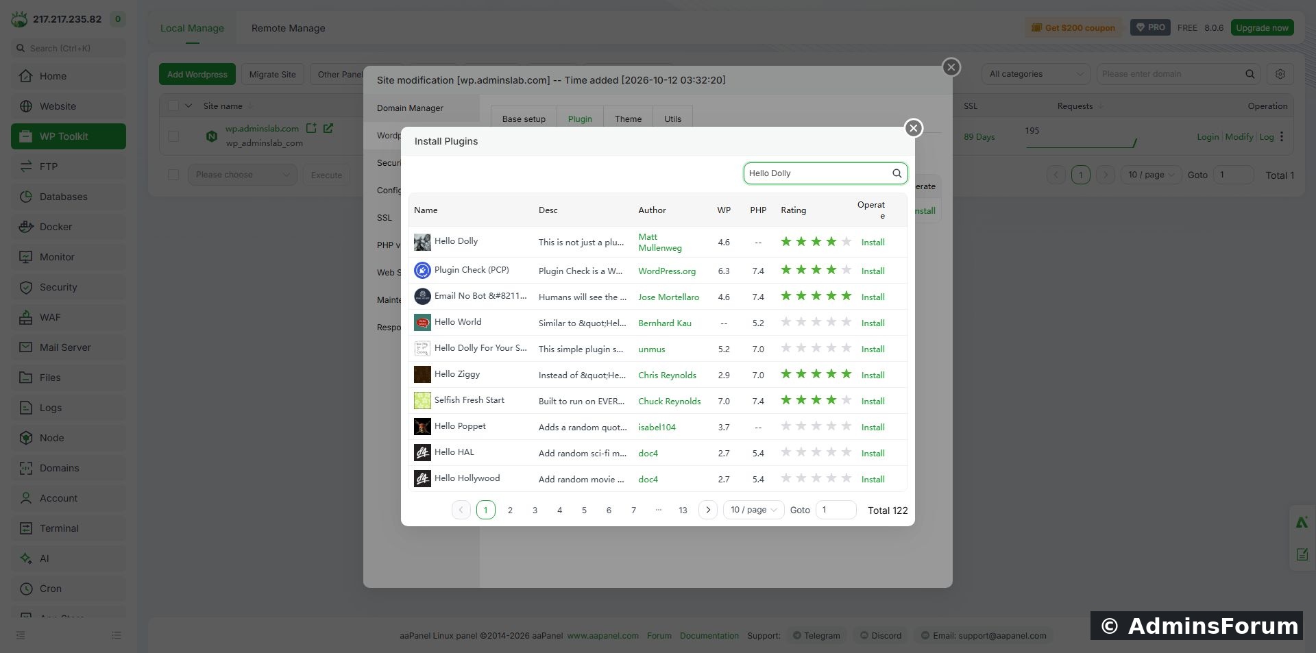

Click Install. In Install Plugins, enter the plugin name in Please enter plugin name and press Enter. Wait for results to load; the table can briefly show placeholders.
For our demonstration, we searched for Hello Dolly and selected the row with Matt Mullenweg as author. Other similarly named plugins appeared, so we checked the author rather than choosing a random search result.
Search results include Name, Desc, Author, WP, PHP, Rating and an Install action. Verify the exact row before proceeding.
The WP and PHP columns are useful requirements information, but do not assume they mean the plugin was tested on your exact installed versions. Review the official WordPress.org listing too. A blank value or dash is not a compatibility guarantee.

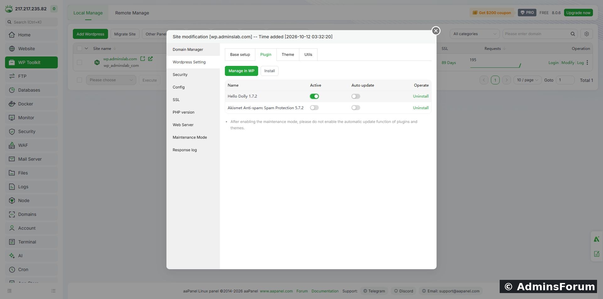

Hello Dolly 1.7.2 appears in the installed list. Both switches were initially off in our test.
Installation and activation are different steps. In our lab, the plugin was installed but inactive. Do not assume that a success message means its functionality is already running.

Find the newly installed plugin’s row. Turn on the switch in the Active column. Wait for the operation to finish and confirm the switch stays on.
Our activation test: Active is on while Auto update remains off.
