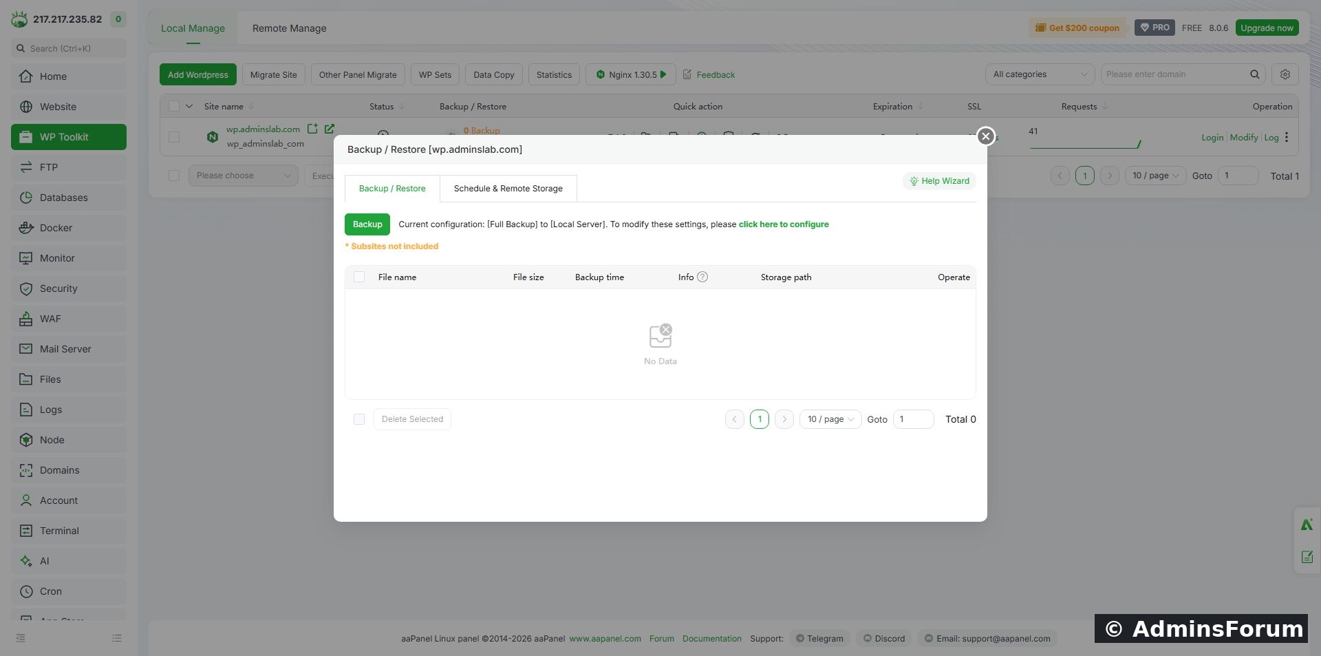

1. Open the website’s backup window
Sign in to aaPanel and choose WP Toolkit in the left menu. Find the correct WordPress domain. Click the Backup link or backup count in its row. A site without a previous backup may show 0 Backup.
The window contains Backup / Restore and Schedule & Remote Storage. For this guide, stay on Backup / Restore. This is a manual backup; it does not require creating a recurring task.
The backup window before our first backup. Check the selected backup type and destination before clicking Backup.
2. Check the backup type and destination
Our window displayed Full Backup to Local Server. If yours is different, use click here to configure and inspect the available choices before starting. Do not assume that a files-only or database-only backup can recover the whole website.
Local Server means the copy remains on the same VPS. It is useful before a plugin update, but it will not protect you if the VPS and its disk are lost. Keep an additional copy outside that server.
The panel also states Subsites not included. If you run WordPress Multisite, do not treat this walkthrough as a complete multisite recovery procedure. Verify the coverage and use a backup method appropriate to your network.

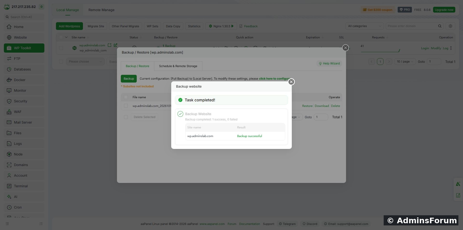

3. Run the backup and wait for completion
Click Backup once. Leave the operation running until aaPanel reports the result. A large site can take longer than this small installation. Do not repeatedly click Backup because the first job is still working.
Our result was 1 success, 0 failed. The table then showed a 35.28 MB archive, marked Full Backup with Local Server storage. Your filename, timestamp and size will differ.
Our completed backup. The successful task result and archive row are both visible.
4. Verify the backup before relying on it
Check that the table contains a new archive with the expected time, a non-zero size and the intended storage location. A missing or unexpectedly small archive needs investigation.
We also inspected the server archive in /www/backup/wordpress/. Its ZIP integrity check passed. It contained meta.json, database.sql.gz and files.zip. The nested website archive contained wp-config.php. These checks confirm that our job produced an archive with database and website-file components; they do not prove that a restoration will succeed.
