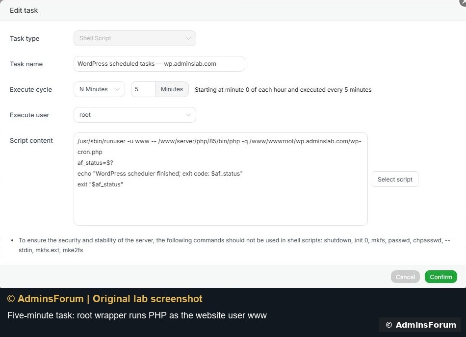

2. Create one task
In aaPanel, open Cron and keep Task type set to Shell Script. Give it a specific name such as “WordPress scheduled tasks — wp.adminslab.com”. Choose N Minutes and set the interval to 5. Check that the description says it executes every five minutes, rather than a daily time or a five-hour interval.
Our panel stores the scheduler wrapper as root, and the command explicitly runs PHP as www. If your panel supports selecting the correct website user directly, use that with the corresponding plain PHP command instead. Do not substitute another OS account without checking its access.
3. Use a command with visible exit status
The exact tested lab wrapper is:
/usr/sbin/runuser -u www -- /www/server/php/85/bin/php -q /www/wwwroot/wp.adminslab.com/wp-cron.php
af_status=$?
echo "WordPress scheduler finished; exit code: $af_status"
exit "$af_status"Keep the exit status: it makes a failed PHP invocation visible. Do not suppress every error and then print a misleading success message. Our first silent version gave an unhelpful empty log, so the tested final version reports the interpreter's result.
Save the task once. Check the task list for an existing equivalent job before adding another.

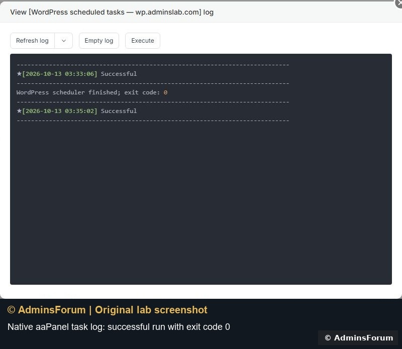

4. Verify the native task
Use Execute for this specific task, confirm the named task and inspect its Log. An empty output is not by itself proof that a due WordPress callback ran.
Our final native log reported exit code 0 and Successful. A subsequent automatic five-minute run also logged success. The existing certificate-renewal task stayed running, and the earlier website/database backup demo tasks stayed stopped.

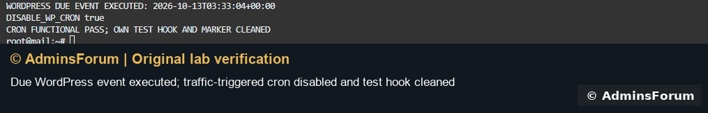

5. Verify an actual due WordPress event
For the lab, we registered a temporary, uniquely named test hook, scheduled it as due and had its callback write a timestamp. The native task processed it. A separate check read the recorded execution time and confirmed DISABLE_WP_CRON was true. The test hook and marker were then cleaned up.
This is stronger evidence than the task's Running label. For your real site, inspect a known due event or a scheduled post after its due time, and review any plugin-specific errors. Do not change every plugin schedule just to create a test.
6. Replace traffic-triggered WP-Cron
Back up wp-config.php privately. Once the server task is ready and its operation is verified, add the following before WordPress loads wp-settings.php:
define('DISABLE_WP_CRON', true);If the new task fails, restore the previous scheduling behavior while you fix the task. Leaving both traffic-triggered and external scheduling disabled can prevent due work from running. The lab's final state keeps the verified five-minute task running and traffic-triggered execution disabled for this site.
