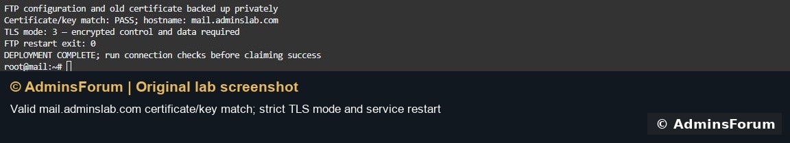

3. Prepare a trusted certificate bundle
Pure-FTPd can load a PEM bundle containing the private key and full certificate chain. In our lab, the existing Let's Encrypt certificate and matching key were verified before creating /etc/ssl/private/pure-ftpd.pem. The bundle is owned by root with permissions 0600. Never post or upload its private key to a forum.
The name entered in your FTP client must match the certificate. Our certificate is valid for mail.adminslab.com, not the server IP.
batch11 ftps cert branded
The lab certificate bundle and strict TLS configuration were verified before restarting the service.

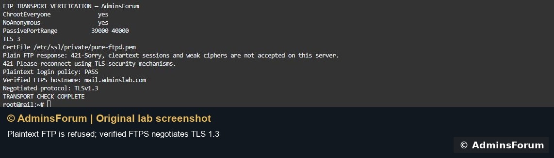

4. Require encryption for both connections
Set the following directives in the active Pure-FTPd configuration:
TLS 3 CertFile /etc/ssl/private/pure-ftpd.pem ChrootEveryone yes NoAnonymous yes PassivePortRange 39000 40000
TLS 3 requires TLS for both the login/control connection and the file-transfer/data connection. TLS 1 permits plaintext FTP, and TLS 2 only requires encryption on the control connection. Save the configuration and restart Pure-FTPd. If the service fails, check its log and restore the backed-up configuration instead of repeatedly changing unrelated settings.

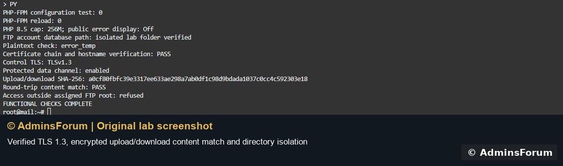

7. Verify the result
Our lab tests confirmed:
  • The certificate chain and hostname were accepted by a client using its normal trusted CA store.
  • The control connection negotiated TLS 1.3.
  • A protected data connection uploaded and downloaded a test file with matching contents and SHA-256 hash.
  • The restricted account could not access another website folder.
  • A plaintext connection was rejected with “Please reconnect using TLS security mechanisms.”
The client test used Python's FTPS client. It proves the server transfer path; it does not claim a FileZilla desktop session was tested.
batch11 ftps transport branded
Plaintext FTP was refused; the certificate-verified connection negotiated TLS 1.3.
batch11 ftps proof branded
Protected upload/download and directory restriction passed.
