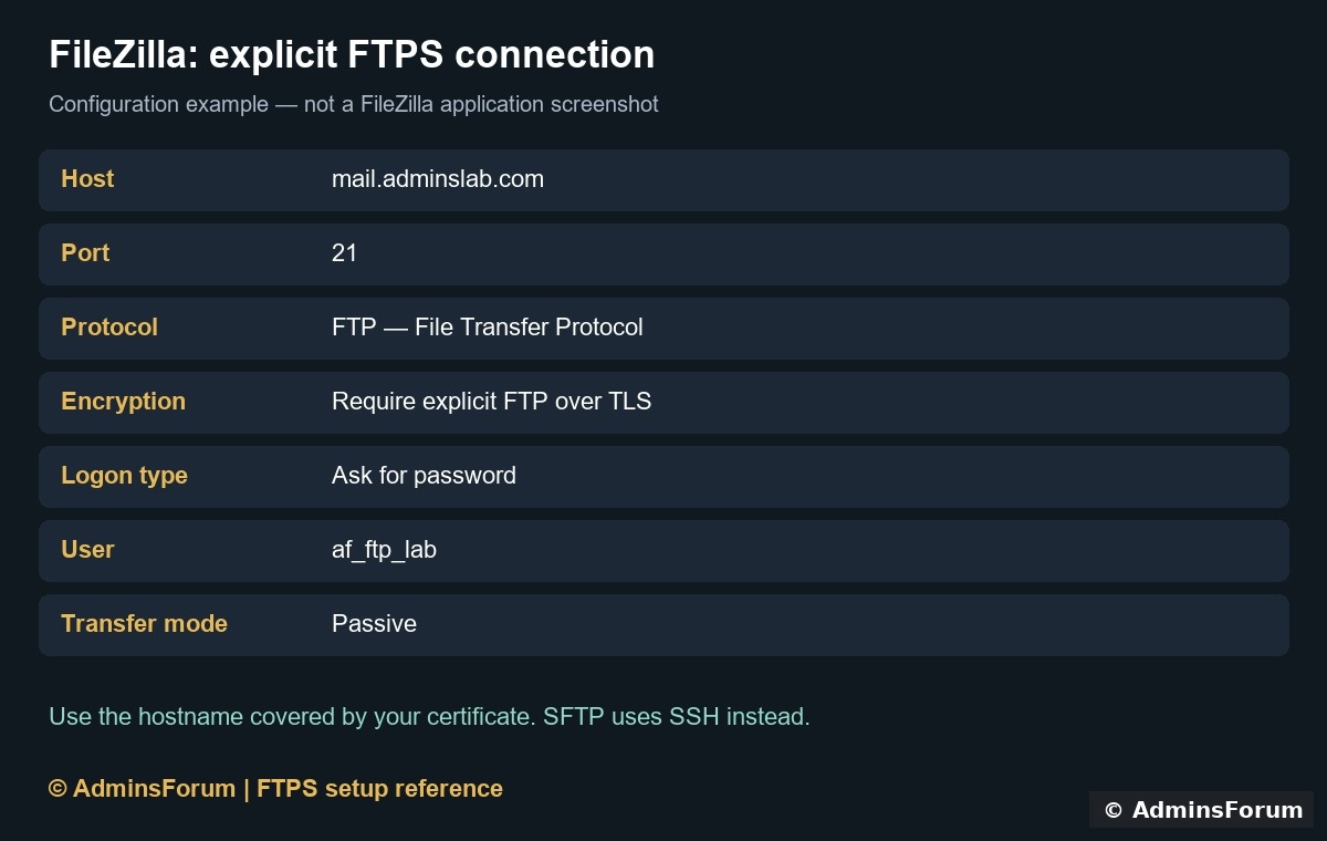

Open File → Site Manager, or press Ctrl+S. Choose New Site and give it a recognizable label such as “AdminsForum lab — FTPS”. Select the General tab and enter your own server details. The following reference shows our lab settings, not a screenshot of a running FileZilla session.
filezilla ftps settings
  • Host: mail.adminslab.com in our lab. Enter your certificate hostname without https:// or a folder path.
  • Port: 21 for this explicit FTPS setup.
  • Protocol: FTP — File Transfer Protocol.
  • Encryption: Require explicit FTP over TLS. Avoid an option that falls back to unencrypted FTP.
  • Logon type: Ask for password, so the saved site does not need to store it permanently.
  • User: your separate restricted FTP username; af_ftp_lab in our test.
In Transfer Settings, use Passive mode. Save the site and select Connect. Enter your own existing FTP password when prompted; do not put it in guide screenshots.

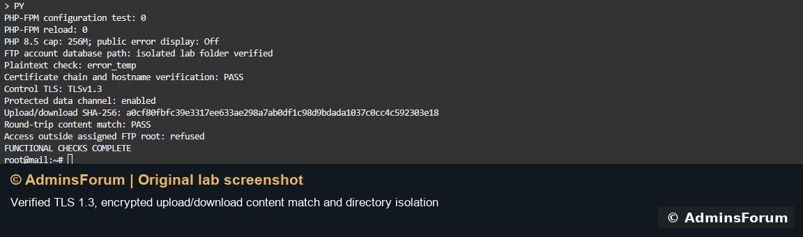

Our backend test accepted the normal certificate chain and mail.adminslab.com hostname, negotiated TLS 1.3 and used encrypted data connections. That server test used a Python FTPS client; this article does not claim that FileZilla desktop screenshots or transfers were captured.

The lab's certificate-verifying FTPS test confirmed matching uploaded/downloaded contents and hash. It also refused access outside the assigned root.
