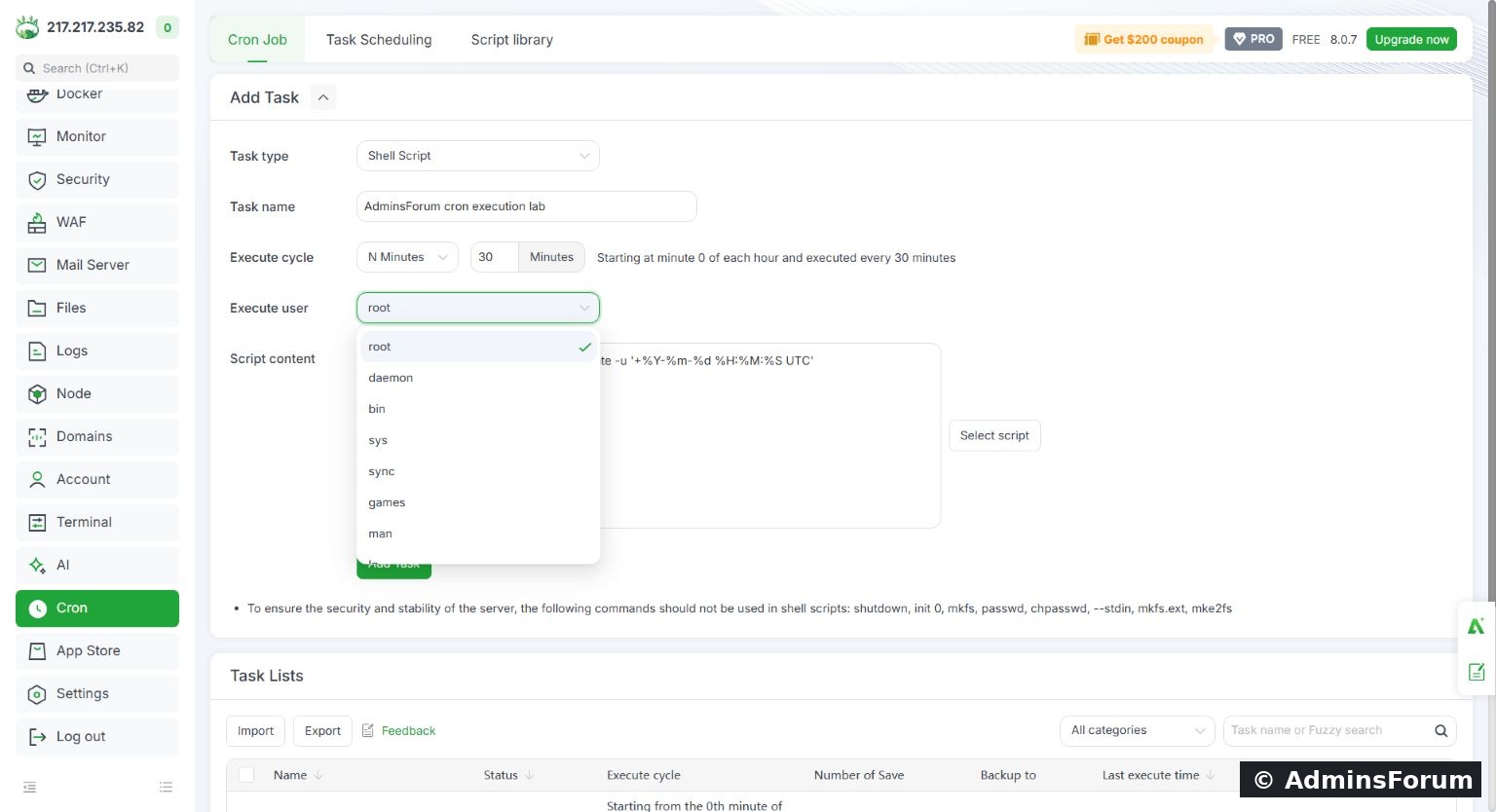

2. Choose a short test interval
Open Execute cycle, select N Minutes and set the interval to 1. In our version the summary states that execution starts at minute 0 of each hour and runs every minute. This short interval is for verification, not a recommendation to run backups every minute.
Other displayed cycle choices include Daily, N Days, Hourly, N Hours, Weekly, Monthly, N Second and Once. Read the resulting schedule summary and confirm the server's timezone before planning a real job. The lab logs use UTC; your local clock may differ.
3. Enter a harmless script
Paste this into Script content:
printf 'AdminsForum cron lab: '; /usr/bin/date -u '+%Y-%m-%d %H:%M:%S UTC'Our disposable lab used the form's default root execution user for this timestamp-only script. For a real application job, select an existing user with only the permissions it needs, and verify file ownership and access. Do not assume a script that works in your own terminal will work under a different user.

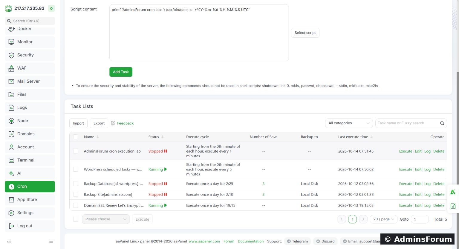

4. Add the task and verify its row
Click Add Task. In Task Lists, find the exact name and confirm its status is Running and its execution cycle is correct. Check the intended task rather than using a batch action against every row.

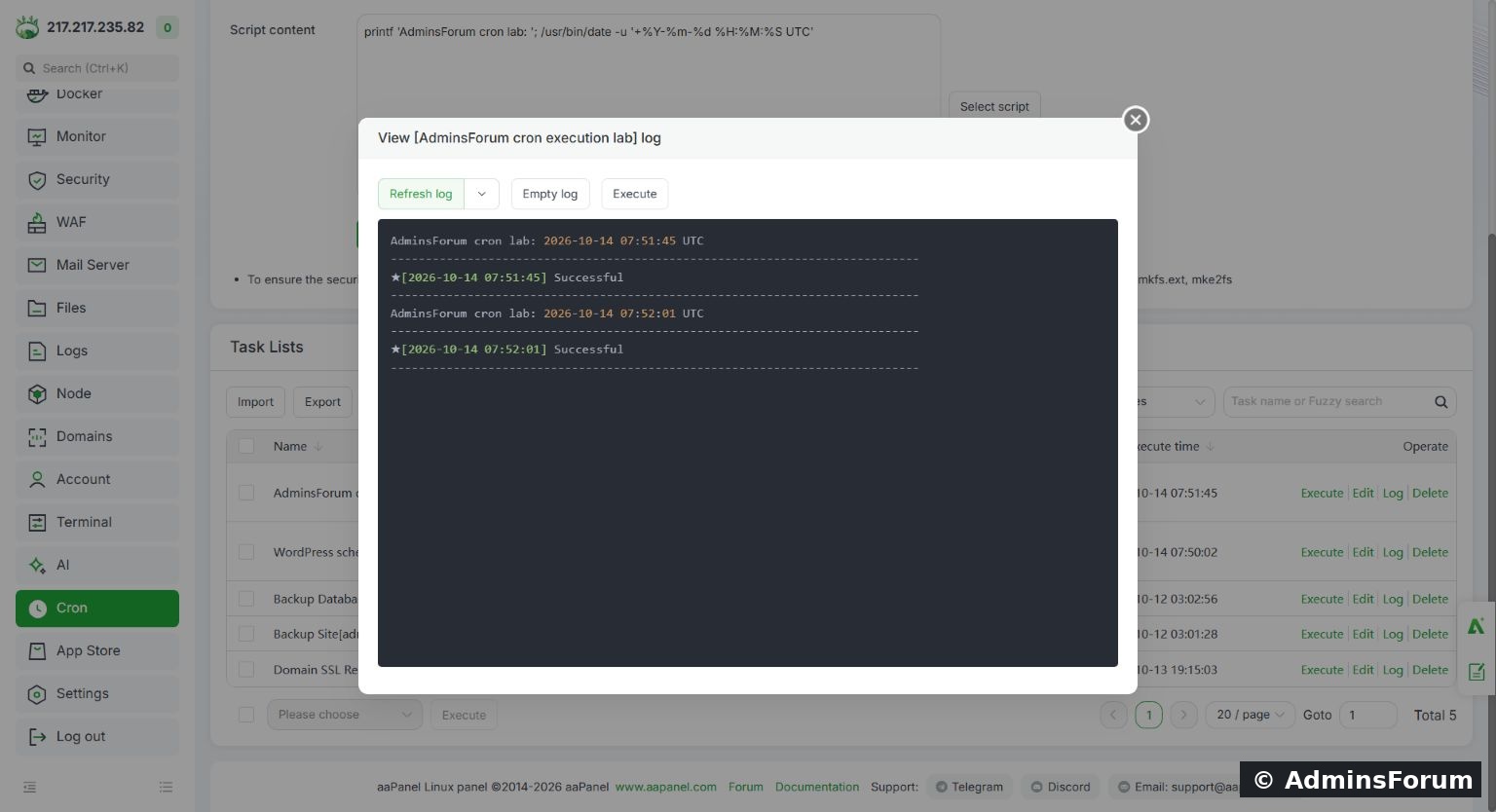

In that task's row, click Execute. Review the confirmation and click Confirm for this harmless script. After execution, click Log. Our first entry showed:
AdminsForum cron lab: 2026-10-14 07:51:45 UTC
Successful6. Verify the automatic run separately
Keep the task enabled and wait for its next schedule boundary. Do not click Execute again during this check. In the log window, use Refresh log. Our next entry appeared automatically:
AdminsForum cron lab: 2026-10-14 07:52:01 UTC
SuccessfulThe log shows the manual execution followed by an automatic execution at the next minute boundary.

7. Stop the lab schedule
Close the log window. Click Running in this task's Status cell. The panel asks whether to deactivate the scheduled task; confirm. The row should change to Stopped.
The completed test task is stopped, so its one-minute schedule no longer keeps running.
