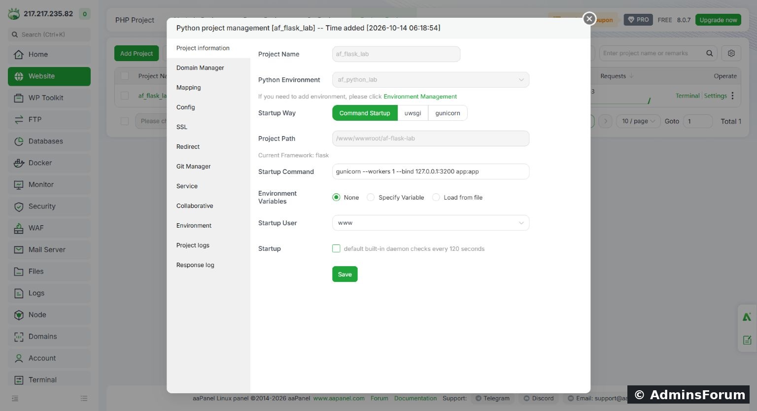

2. Enable aaPanel's Startup option
Click the project name, then open Project information. Locate Startup and tick the checkbox labelled default built-in daemon checks every 120 seconds. Click Save.
Enable the native Startup checkbox for the correct Python project, then save its settings.
This setting tells aaPanel to recover the project when its daemon finds it stopped. It is not an immediate availability guarantee: the panel advertises a 120-second check interval. Keep the same working startup command, environment, project path and non-root user.
Our command remained:
gunicorn --workers 1 --bind 127.0.0.1:3200 app:app
The selected environment was af_python_lab and the startup user was www. Do not create a second systemd or cron launcher for the same process while using the native panel daemon; two launchers can compete for the same port.
