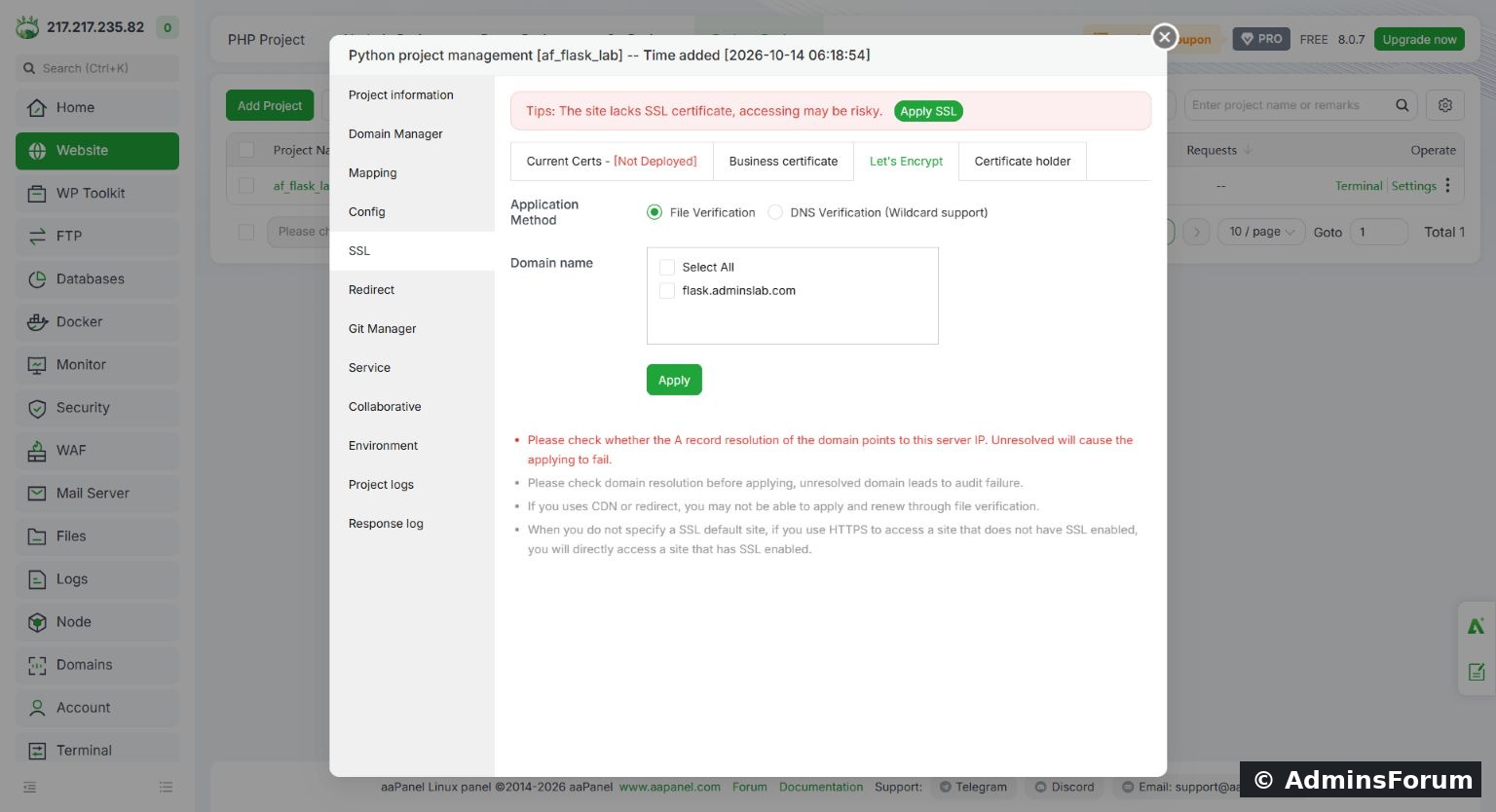

In the project's management window, open SSL → Let's Encrypt. Choose File Verification, select the exact hostname and click Apply. File verification requires the certificate authority to reach the hostname on port 80.
Select only the hostname that resolves to this project before applying for its certificate.

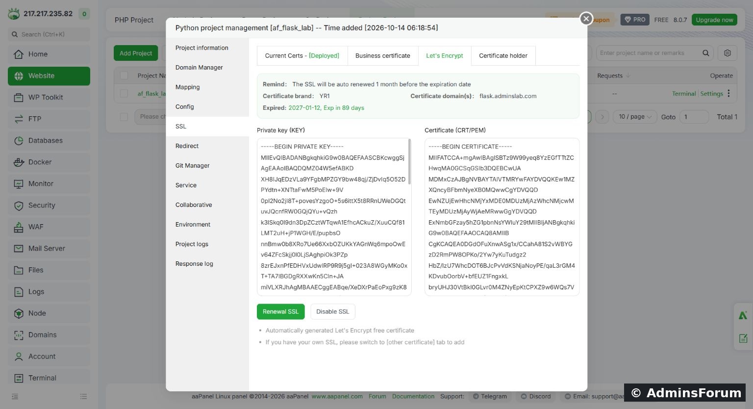

Some panel versions display Not connected to the Domain Management Center and a Connect action. Review that integration before connecting your domain, then return to the certificate request. Wait for issuance to finish; a pending request is not an installed certificate.
In this lab, the SSL section changed to Current Certs — Deployed, listed flask.adminslab.com and showed an expiry date of 12 January 2027. We also validated the live certificate independently. Do not copy or share the private-key field from the certificate screen.

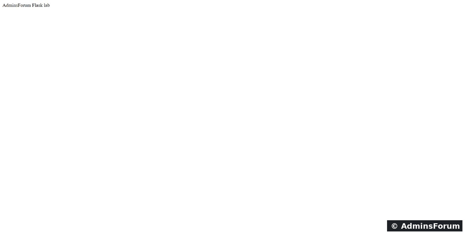

Open https://your-hostname/ in a browser. The page must display the expected application without a certificate warning. From a terminal, you can also test:
curl -i https://your-hostname/
Do not use curl -k for this check: it skips certificate validation and can hide a broken certificate.
The public HTTPS hostname serves the expected Flask lab response.
Our result: https://flask.adminslab.com/ returned HTTP 200 with AdminsForum Flask lab, and certificate validation passed. This confirms DNS, Nginx mapping, the running application and HTTPS worked together at the time of testing.
