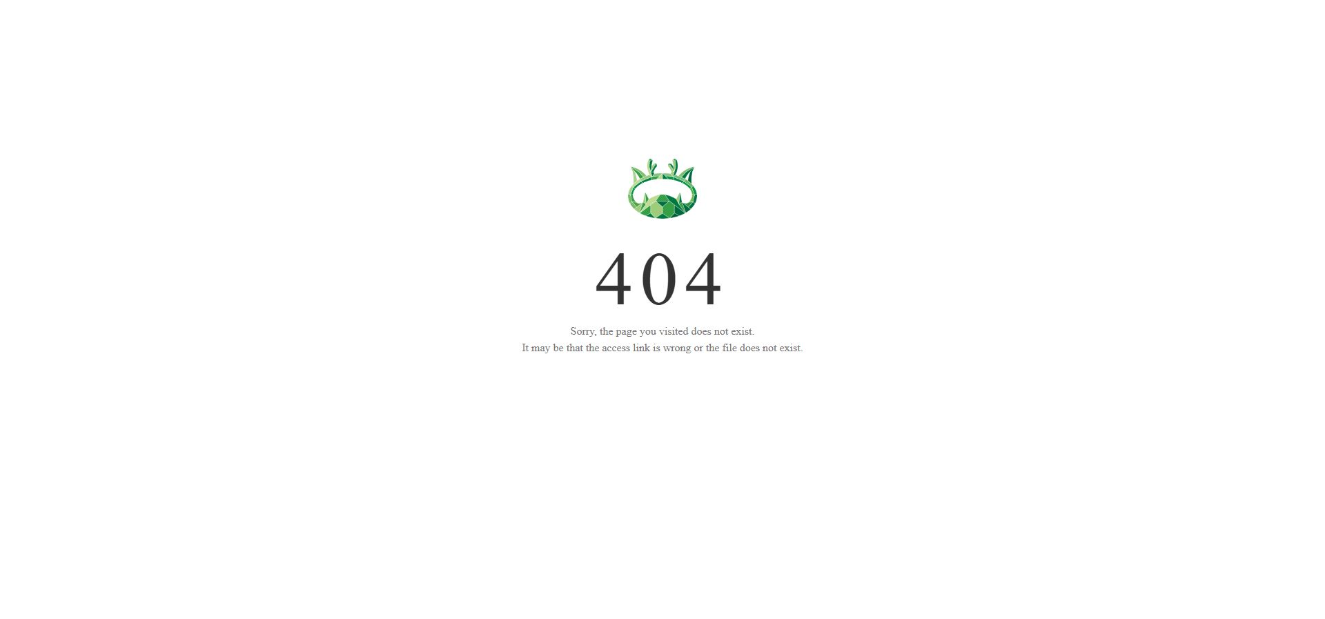

Open the affected URL once. Write down its path, the approximate time, and the message shown. Use a harmless missing path on your own test site if you want to practise:
Our test displayed the 404 page shown below. This is an intentional missing-page result, not an installation failure.
AdminsForum lab screenshot — deliberate 404 response

1. Reproduce the problem and record the time
https://your-domain.example/af-log-tutorial-missing-pageAdminsForum lab screenshot — deliberate 404 response
![[Image: aapanel-log-404-tested-20261011.png?v=1]](https://adminsforum.com/uploads/tutorials/aapanel-log-404-tested-20261011.png?v=1)
