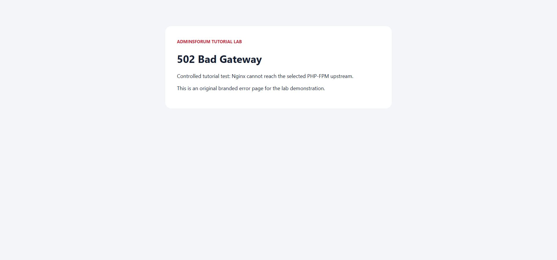

How do you fix a 502 after changing PHP version in aaPanel?
Check the site's Nginx error log, confirm its selected PHP version, and verify that the matching PHP-FPM service is healthy and listening where Nginx expects it. Restore the last working selection if necessary and application-compatible. A 502 alone does not identify the cause.
Scope and review: Documentation reviewed 9 October 2026. This covers Nginx with panel-managed PHP-FPM after a PHP-version change, not every 502 or an OpenLiteSpeed/Apache deployment. Fresh-VPS reproduction and screenshots are pending. Record aaPanel, OS, Nginx and PHP versions. PHP 8.3 and example.com below are placeholders.
