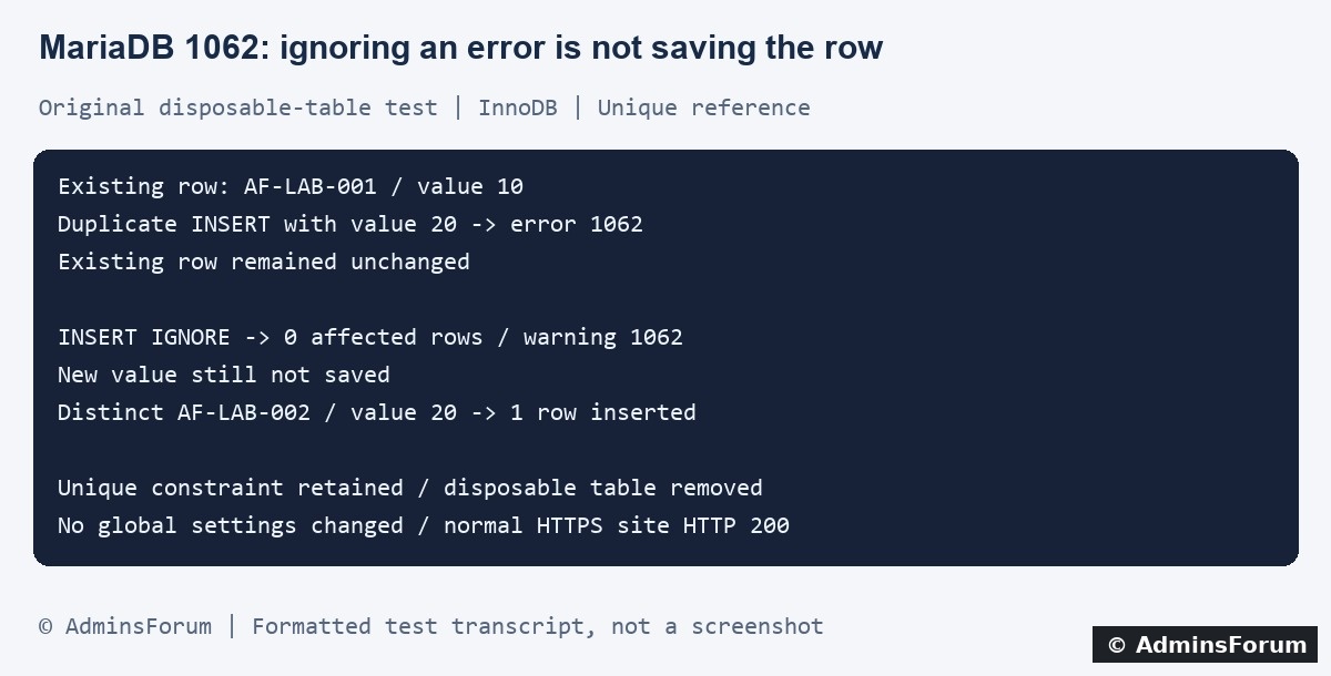

We used MariaDB 10.11.10 and a disposable two-column data example with an auto-increment primary key and an additional unique reference index. Initially AF-LAB-001 had value 10.
- A normal INSERT of AF-LAB-001 with value 20 returned 1062. A read-back confirmed the existing value remained 10.
- The same duplicate with INSERT IGNORE reported zero affected rows and warning 1062. A read-back again showed only the existing value 10: the proposed value 20 was not saved.
- An intentionally distinct AF-LAB-002 record with value 20 inserted successfully. The final reference/value pairs were AF-LAB-001 → 10 and AF-LAB-002 → 20.

- INSERT IGNORE: our test showed that a duplicate can become a warning while the row is not inserted. Review affected rows, warnings and final data; a command completing without an error is not proof all input was saved.
