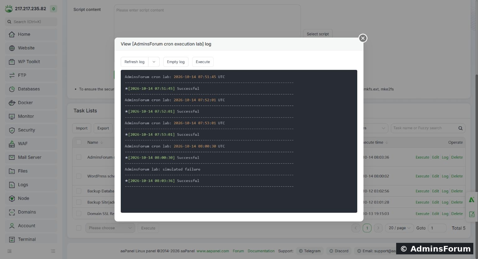

Click the task's Log link and use Refresh log. Match the newest timestamp to the run you are investigating. Check stderr messages, missing files, command errors and the output you expected the script to create.
Our controlled failure script was:
printf 'AdminsForum lab: simulated failure ' >&2 exit 7
This only prints a diagnostic message and returns a nonzero status. It does not delete data or alter a service. Use it only in a disposable test job, not as a replacement for your live script.
The log contains simulated failure output followed by a Successful footer in the tested panel version.
The generated wrapper in this lab printed its Successful footer without checking the preceding user script's exit result. Therefore the footer cannot, by itself, establish successful application work. This finding is scoped to our installed version and shell-task wrapper; we did not assume identical behavior for every task type or release.

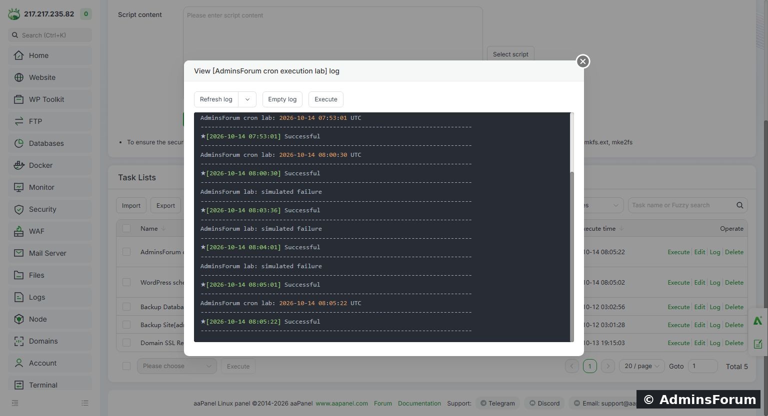

Save the reviewed script. Use Execute for a controlled manual run, then inspect fresh output. In our lab we restored:
printf 'AdminsForum cron lab: '; /usr/bin/date -u '+%Y-%m-%d %H:%M:%S UTC'
Because the test task was active when the corrected content was saved, its generated execution file was updated. The next manual execution printed the expected timestamp rather than the simulated failure text.
The later log entry contains the recovered timestamp output. This concrete output proves our script correction took effect.
We then disabled the lab task and confirmed its status was Stopped. This recovery test checks manual execution after a script change. Automatic timestamp scheduling was verified separately in the introductory cron guide; it was not inferred from the manual run here.
