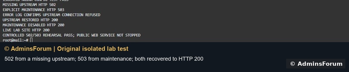

We used a separate Nginx configuration bound only to localhost, without stopping or reconfiguring the public web service. A missing local upstream produced HTTP 502 and a connection-refused error log. An explicit maintenance response produced HTTP 503. Starting the intended upstream restored its route to 200, and removing the test maintenance response restored that route to 200. The public WordPress site also returned 200.
These were controlled examples on the lab, not claims that a current public-site outage had either specific cause. The temporary test listeners were closed afterward.

In our isolated test, only the expected local upstream needed to start. The same Nginx route then returned HTTP 200.

Our demonstration used a deliberate Nginx maintenance response. Removing that test response and validating/reloading the test configuration restored 200. Starting PHP would not change an explicit return rule.

A brief 200 from a static page is not enough if the failing route executes PHP or another backend. Our test specifically rechecked the previously failing upstream route, the maintenance route and the public WordPress home page.
