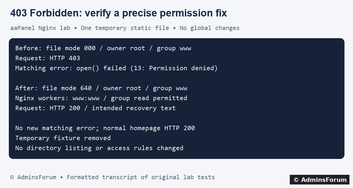

Tested: aaPanel Free 8.0.7, Ubuntu 22.04.5 and Nginx 1.30.5. We created one temporary public-text fixture, withheld file access to reproduce a permission-related 403, then permitted group read on that file and verified HTTP 200. It was removed afterwards. No application directory, access rule or global service setting was changed.

Our test request appeared as 403 in the access log. The corresponding Nginx error named the temporary text file and reported:
open() ... failed (13: Permission denied)
This supported a filesystem-access diagnosis for that static file. It was different from a missing file (404) or an undefined PHP function (500).

Our fixture's parents were traversable, and the denied file had mode 000 with owner root and group www. No parent permissions were changed during the test.
4. Confirm the process that needs access
Our Nginx master ran as root, but its workers ran as www:www. The worker identity is the relevant one for this static request; an administrator being able to read the file does not prove the web worker can.

For our existing fixture ownership root:www, mode 640 gave the owner read/write, the group read and others no access. Because the workers used group www, this permitted the intended static response without allowing them to write to the file.
Our one-file repair was equivalent to:
chmod 640 /www/wwwroot/adminslab.com/af-http403-lab-20261014.txt
That path was our disposable text fixture. Before adapting the command, verify the intended owner/group and runtime identity, record the original mode and select only the affected file. It does not change ownership or grant a different group access.

AdminsForum formatted transcript of the original experiment, not a panel screenshot.

After the targeted file change, the same URL returned HTTP 200 with the expected text. The access log recorded 200, no new error entry matched that file, and the normal homepage also returned 200.
No Nginx reload or restart was needed for this filesystem-mode change. If you instead edit a server configuration, validate it and use the supported reload procedure before testing its behavior.
We removed the temporary fixture after verification. The deliberately inaccessible file should not be left as a public test URL. Existing application files and permissions remained untouched.
