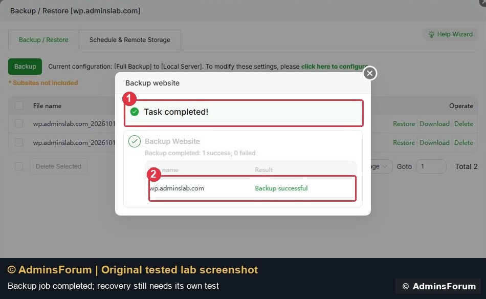

1. Create a current full backup
Open WP Toolkit, find the correct domain and click its Backup / Restore entry. Check that the configured backup type includes both files and database, then start the backup and wait for the job to finish.
Our task displayed 1 success, 0 failed. If yours fails, investigate that job before testing restoration. See the backup creation walkthrough for the initial panel steps.

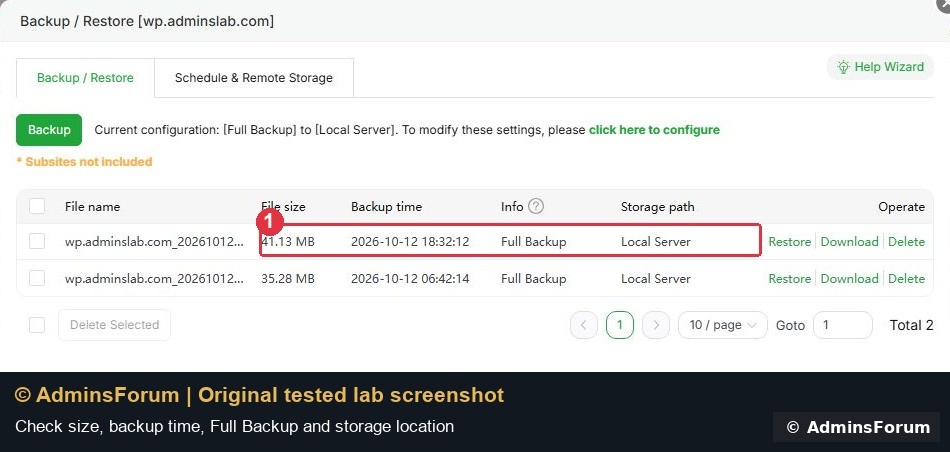

2. Identify the exact archive
In the backup list, check the domain, backup time, file size, backup type and storage location. Do not select an older archive just because it is first in a downloaded folder.
Our selected entry was:
  • File: wp.adminslab.com_20261012_153210.zip
  • Size displayed by aaPanel: 41.13 MB
  • Type: Full Backup
  • Storage: Local Server
wp backup check list branded
The panel's displayed backup time can use a different timezone from a timestamp embedded in the filename. Record the exact filename and check the selected site's identity. The warning Subsites not included also matters: a backup of the parent site is not proof that every separate subsite has been captured.

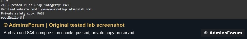

4. Check the archive without restoring it
Our full-backup ZIP contained meta.json, database.sql.gz and files.zip. We checked the outer ZIP, decompressed the SQL gzip, tested the nested files ZIP and confirmed wp-config.php was included.
The following read-only example was also tested against this archive. Open the aaPanel Terminal and change the p = Path(...) line to your actual backup file before running it. It needs Python 3 and its standard library; it does not extract files into your website, import SQL or modify the backup.
python3 - <<'PY' from pathlib import Path import gzip, io, json, zipfile p = Path('/www/backup/wordpress/wp.adminslab.com_20261012_153210.zip') if not p.is_file():     raise SystemExit('STOP: backup file not found') with zipfile.ZipFile(p) as archive:     if archive.testzip() is not None:         raise SystemExit('STOP: outer ZIP integrity failed')     required = {'meta.json', 'database.sql.gz', 'files.zip'}     if not required.issubset(archive.namelist()):         raise SystemExit('STOP: expected full-backup components missing')     meta = json.loads(archive.read('meta.json'))     print('Backup domain:', meta.get('domain'))     print('Backup site root:', meta.get('site_path'))     sql = gzip.decompress(archive.read('database.sql.gz'))     if not sql:         raise SystemExit('STOP: SQL data is empty')     print('SQL compression and non-empty data: PASS')     with zipfile.ZipFile(io.BytesIO(archive.read('files.zip'))) as files:         if files.testzip() is not None:             raise SystemExit('STOP: nested files ZIP integrity failed')         if not any(n.endswith('wp-config.php') for n in files.namelist()):             raise SystemExit('STOP: wp-config.php missing')     print('Files ZIP integrity and wp-config.php presence: PASS') print('Integrity checks finished. A restore test is still required.') PY
This example matches the archive layout observed in our aaPanel version. A different backup format needs a different check; a missing component should be investigated rather than renamed to make the script pass. It loads the compressed components into memory, so for large backups use an appropriate streaming/offline verification process instead of copying this small-lab example blindly.
wp backup check integrity branded
Read the result carefully:
  • The domain and site root should describe the website you intended to back up.
  • ZIP integrity checks detect archive corruption; they do not prove the application data is complete or safe.
  • Successful SQL gzip decompression and non-empty data do not prove that the SQL will import successfully or contain every required table.
  • wp-config.php being present confirms inclusion of that file, not that its database settings match the restore target.
