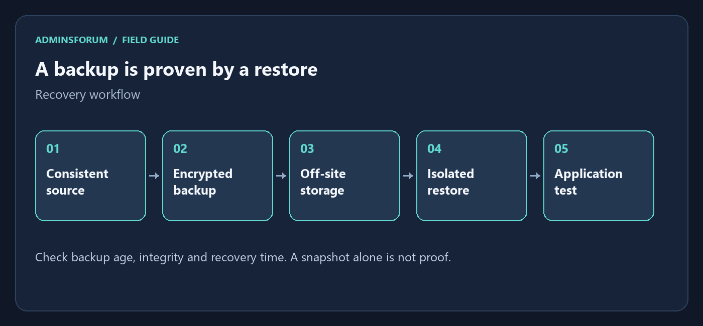

[Image: attachment.php?aid=1]
Recovery workflow: a backup is proven by an isolated restore and application test.
