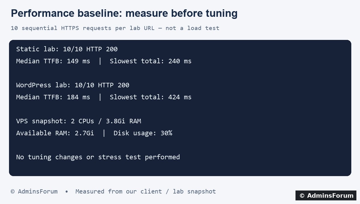

4. Repeat a small sequential sample
We sent ten separate sequential requests to the static lab homepage and ten to the WordPress lab homepage, with a short delay between requests. Each request used a fresh curl process. This was a small diagnostic sample, not a concurrent load test.
Measured lab results, rounded for readability. The image is a formatted transcript rather than a performance guarantee.
Our client-side results were:
  • Static lab: 10/10 requests returned HTTP 200. Median TTFB 149 ms; slowest total response 240 ms.
  • WordPress lab: 10/10 requests returned HTTP 200. Median TTFB 184 ms; slowest total response 424 ms.
These timings include the network path from our client. We did not independently isolate application cache state, PHP time or SQL time in this introductory sample. The ten-request sample is too small to make strong tail-latency or capacity claims.
