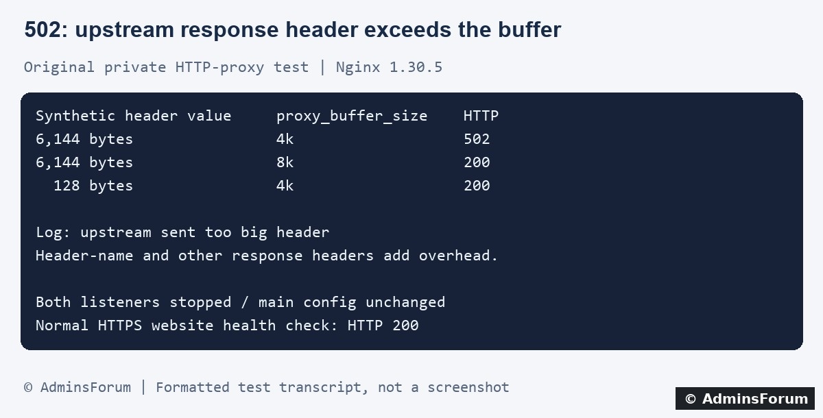

4. What the isolated lab test demonstrated
We used Nginx 1.30.5 with a separate configuration and a dummy HTTP upstream. Both listeners were bound only to loopback. The upstream returned one harmless padded header and a fixed test message; no real cookies or credentials were used.
  • With a 6,144-byte synthetic header value and a 4k proxy_buffer_size, the request returned 502 and the log recorded the exact oversized-header error.
  • Changing only that buffer to 8k, within the already compatible private buffer configuration, returned 200 with the expected body.
  • Restoring the original 4k buffer and reducing the synthetic header value to 128 bytes also returned 200.
Those byte counts describe only the padded header's value. Its name, separators, status line and other response headers add overhead. These values are a demonstration, not an exact maximum usable header size or a production recommendation.
Only three requests were measured. We did not test a PHP application's cookies, CDN limits or browser acceptance of large headers. Both temporary listeners were stopped and the isolated PID file disappeared. The main Nginx configuration hash stayed unchanged, and the normal HTTPS website returned 200 afterward.
