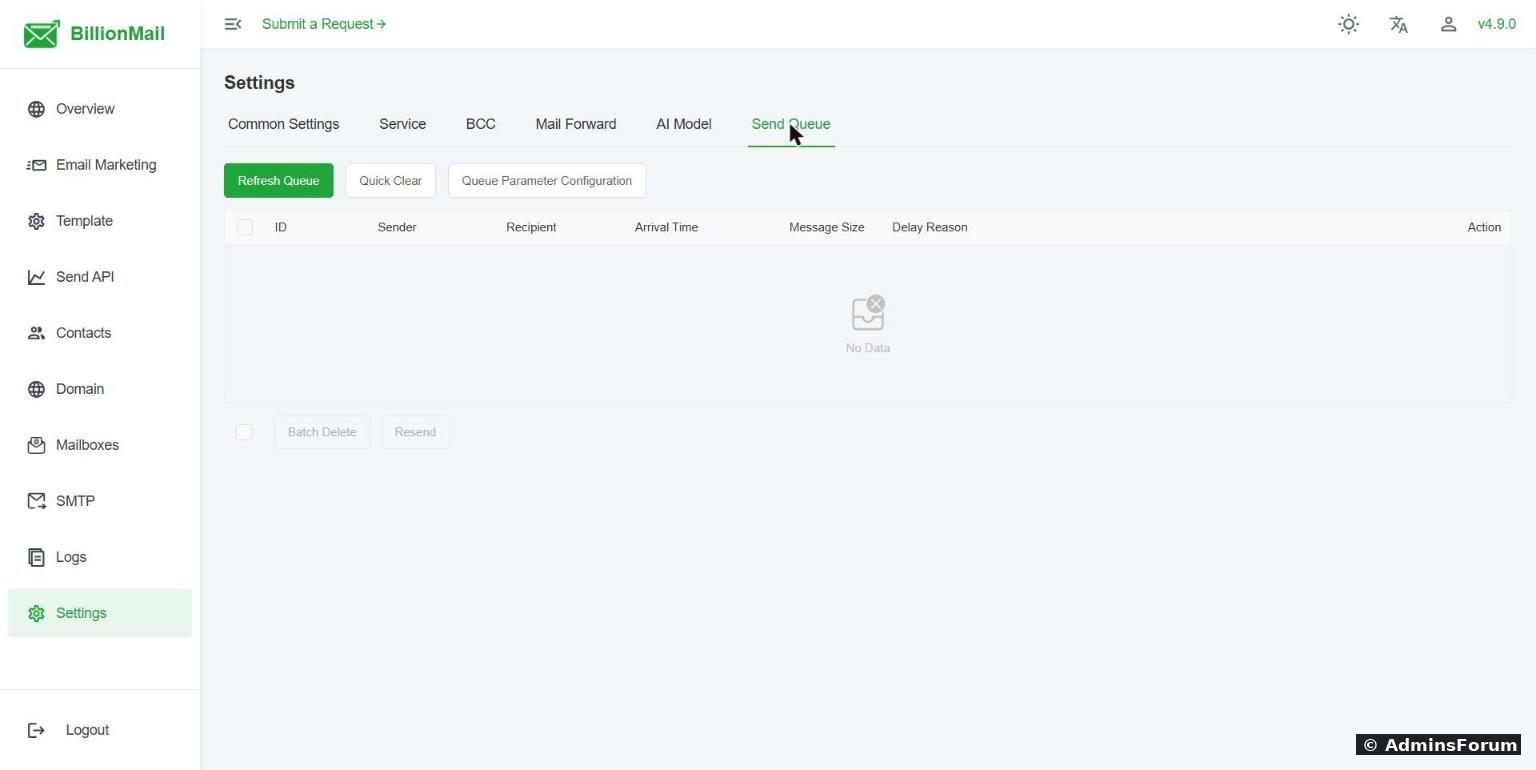

Where to find the queue
Open Settings > Send Queue. At the top you'll find three buttons and a table:
[Image: attachment.php?aid=424]
  • Refresh Queue reloads the list.
  • Quick Clear deletes the queued messages. Use it only when you're sure you don't want them sent.
  • Queue Parameter Configuration lets you adjust how the queue behaves. The defaults are fine for most people.
  • The Delay Reason column is the important one.
An empty list means everything was delivered.
