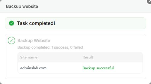

3. Create the backup
Click Backup and wait for the task to complete. Confirm the archive appears with its file size, time, backup type and storage destination. Our small lab site produced a ZIP archive; actual sizes vary.
[Image: attachment.php?aid=23]
AdminsForum tutorial lab: aaPanel reports the website backup completed successfully.
