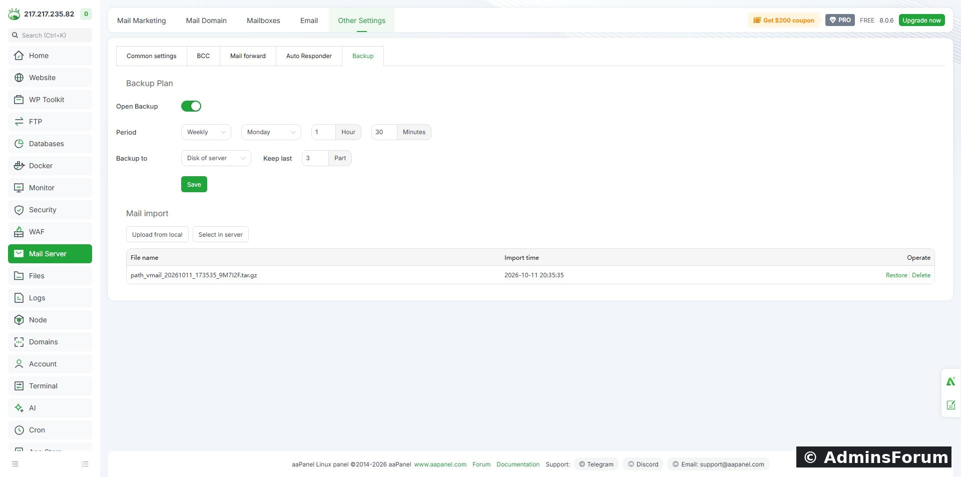

2. Choose the schedule and retention
Turn on Open Backup. For the lab demonstration we selected:
- Period: Weekly.
- Day: Monday.
- Time: 01:30, using the server's schedule/time settings.
- Backup to: Disk of server.
- Keep last: 3 copies.
AdminsForum lab screenshot — saved plan and the generated archive
![[Image: mail-backup-result-20261011.png?v=copyright1]](https://adminsforum.com/images/tutorials/mail-backup-result-20261011.png?v=copyright1)

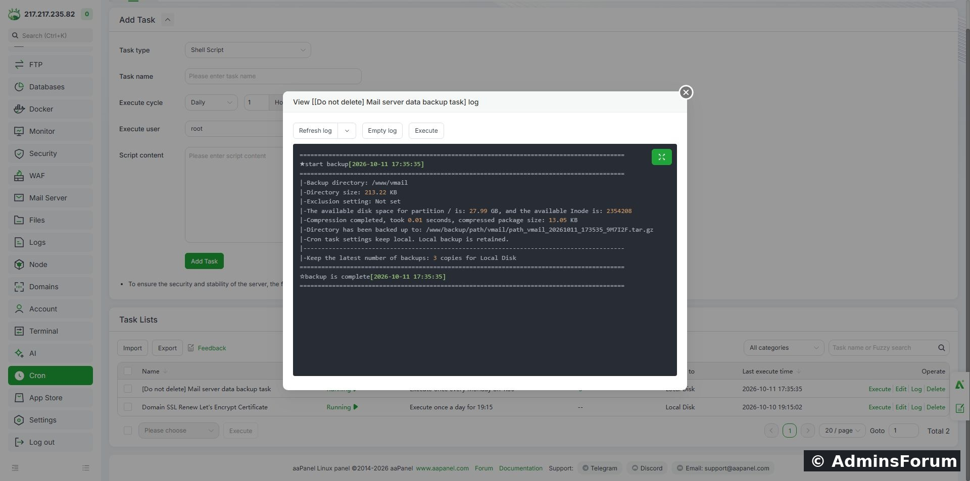

4. Read the backup log
Open the task's Log. Look for the source directory, available disk space, compression result, destination filename, and a completion message. Our lab log reported:
Backup directory: /www/vmail
Directory size: 213.22 KB
Compressed archive: 13.05 KB
Saved under: /www/backup/path/vmail/
Backup is completeAdminsForum lab screenshot — successful execution log
![[Image: mail-backup-log-20261011.png?v=copyright1]](https://adminsforum.com/images/tutorials/mail-backup-log-20261011.png?v=copyright1)
5. Check and keep an off-server copy
Return to Mail Server → Other Settings → Backup. In our tested version the generated archive appeared under Mail import, with Restore and Delete actions. Check its timestamp and filename against the task log.
Use aaPanel Files to open the exact directory shown in your log. Download the archive to secure storage outside the VPS. Backups contain private email, so do not put them in a public website directory or attach them to a forum post. Check that the downloaded file has a sensible size and can be opened/listed as an archive.
