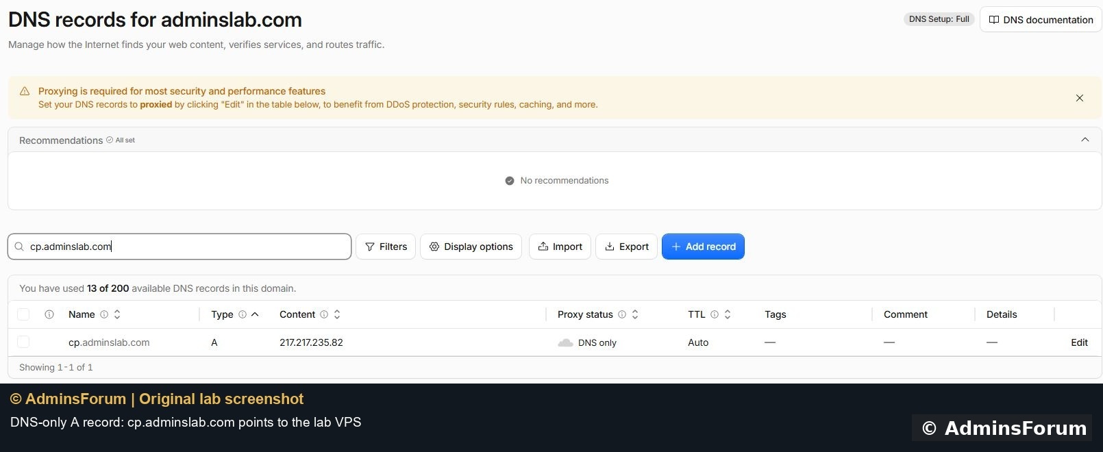

1. Add the DNS record
In Cloudflare, select the correct domain → DNS → Records → Add record. Choose A, enter cp as the name and your VPS IPv4 address as the content. Turn Proxy status off so it says DNS only, leave TTL at Auto and save.
panel dns branded
Our saved record resolves cp.adminslab.com to the lab VPS. Replace that domain and address with your own values. Do not change your main website or mail records while adding the panel record.
The lab's port 18443 is outside Cloudflare's ordinary supported proxy ports. Orange-cloud proxying would not make this direct panel URL work. DNS only sends the browser directly to the origin; retain your server firewall and panel authentication.

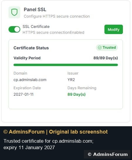

3. Install HTTPS before signing in through the hostname
A certificate issued for the server IP will not automatically cover the new domain. In Settings → Panel SSL → Modify, use the certificate workflow for the panel hostname. Our native Let's Encrypt workflow applied and deployed a certificate for cp.adminslab.com.
panel cert branded
We verified its chain and hostname with normal certificate checks, negotiated TLS 1.3 and then signed in through the domain. Its displayed expiry is 11 January 2027. This is evidence from the lab, not a promise that your application will complete without DNS or validation fixes.
