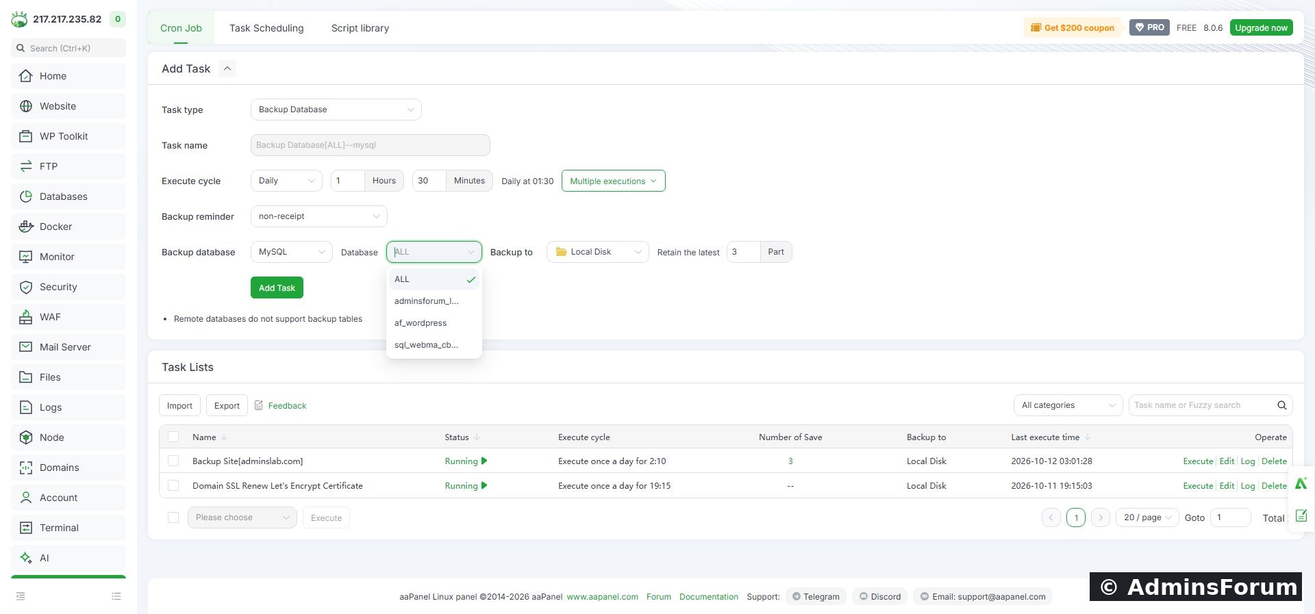

2. Open the backup task form
Click Cron in the left-hand menu. Under Add Task, set Task type to Backup Database. In Backup database, select MySQL for this MySQL/MariaDB example. The lab runs MariaDB but aaPanel presents this engine family as MySQL in the task form.
Use Database to select the required database instead of leaving ALL selected unless every listed database should be included. The task name is generated from your selection.
3. Choose a time and destination
Set Execute cycle to Daily and enter the hour and minute. We used 02:25 so it did not start at the same time as the website-file job. Check the server clock and time zone first. Staggering jobs helps avoid simultaneous compression and database activity, but does not guarantee that file and database backups represent the same instant.
For this first test we selected Local Disk and kept the latest three copies. Choose a retention count based on available space and how far back you need to recover. Repeated manual executions can also create copies; retention is not automatically equivalent to a number of days.
AdminsForum lab: the selected WordPress database, daily schedule, local destination and copy count.
The Backup reminder setting was left at non-receipt. No notification delivery was tested. If you enable alerts later, test the notification channel rather than assuming it works.

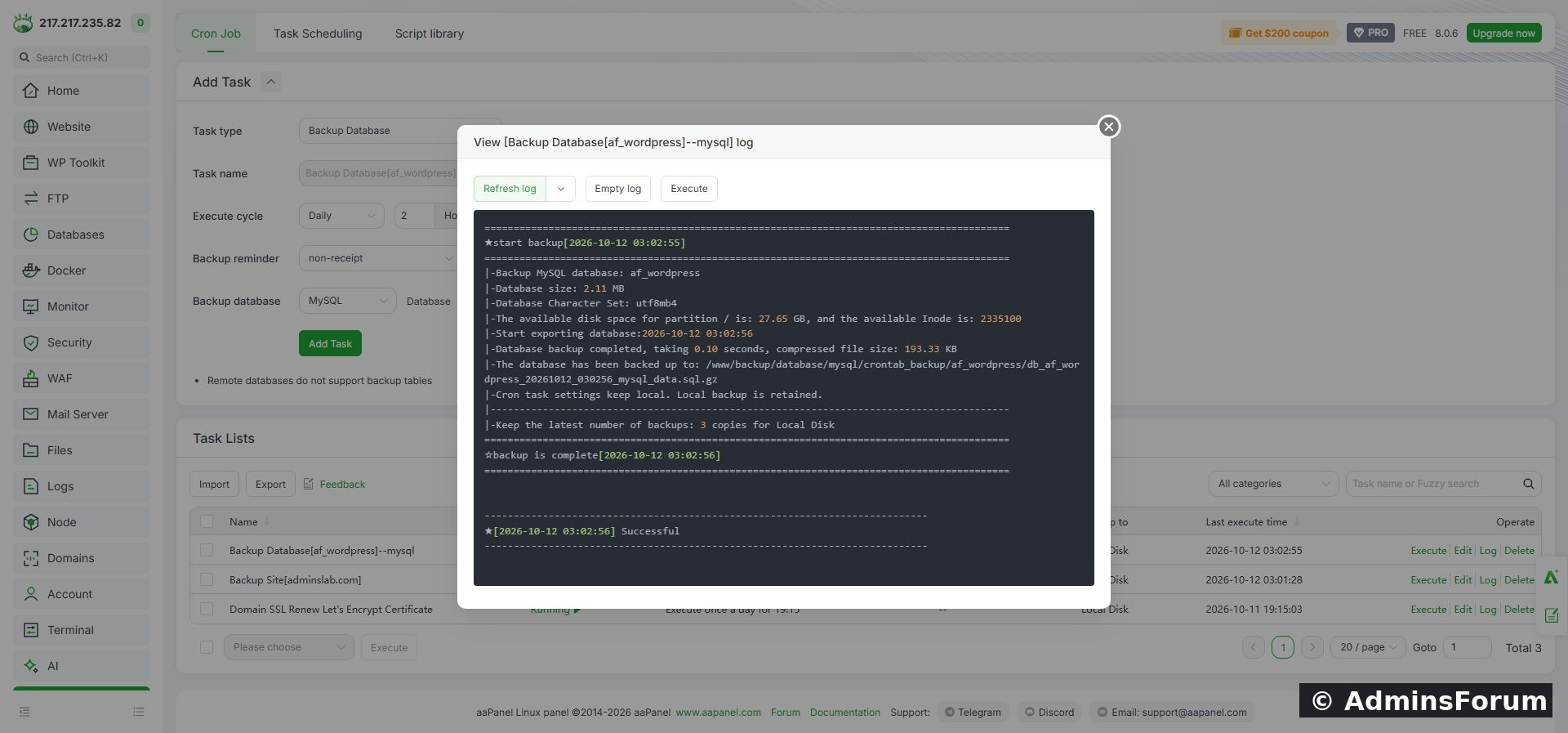

4. Create the task and run it once
Click Add Task. Check the new row's database name, Running status, time and destination. Click Execute in that exact row and confirm the prompt. Wait for the export and compression to finish, then read Log or use Refresh log.
AdminsForum lab: successful database export, compressed size, output path and retention result.
A successful result should identify the database you intended and the location of a non-empty archive. A task being present in the list does not prove a backup was produced.
Our archive was placed under:
/www/backup/database/mysql/crontab_backup/af_wordpress/
The log provided its exact timestamped filename. Your version or storage configuration may use a different path; follow your own log.
