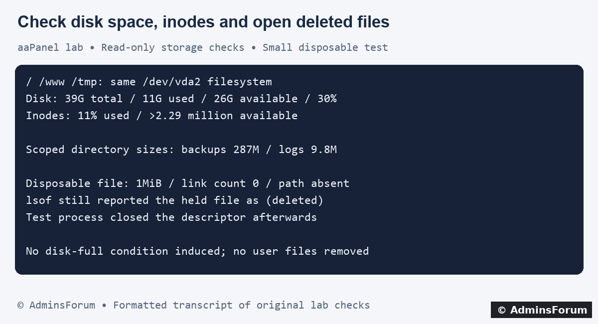

Our read-only checks were:
df -h / /www /tmp df -i / /www /tmp
All three paths belonged to /dev/vda2, mounted at /. They therefore shared capacity; their three available values must not be added together.
The rounded disk result was 39G total, 11G used, 26G available and 30% usage. The inode snapshot showed 2,555,904 total objects, 263,510 used and 2,292,394 available, or 11% usage. Neither resource was exhausted in this lab.
For a real error, substitute the exact paths used by the failed write. Many tiny files can exhaust inodes while bytes remain, whereas a separate temporary volume may run out without filling the website's volume.
C. Measure relevant directory growth
du -x -h --max-depth=1 /www/backup /www/wwwlogs
The scoped lab results were approximately 287M for backups and 9.8M for logs. They do not explain every byte on /. We removed nothing from these directories because available capacity did not justify speculative cleanup.
Display depth limits the detail shown, not all traversal work. Large scans can cause I/O, so narrow the scope and compare growth over time. Determine which application owns the data and what its retention policy permits before removing it.
[Image: storage-diagnostics-20261014.jpg]
AdminsForum formatted transcript of the original checks, not a panel screenshot.
D. Why deleting a filename may not reclaim storage
Our isolated test wrote and flushed a 1MiB disposable file, unlinked its path while holding the descriptor open, and inspected only the test process. The path no longer existed, the link count was zero, and the descriptor still showed 1,048,576 allocated bytes. lsof reported the held object as (deleted).
The test process then closed the descriptor and exited, leaving no temporary data file. This demonstrates open-file behavior; it does not claim a large measured df/du discrepancy or a specific amount recoverable from a real service.
For a real investigation:
lsof -nP +L1
Inspect the relevant process and filesystem privately. The -nP options avoid resolving names/port names; +L1 selects unlinked open files. Permissions and namespaces affect visibility. Use the owning service's supported rotation/reopen or carefully planned graceful restart process rather than blindly killing it or truncating a live descriptor through /proc.
