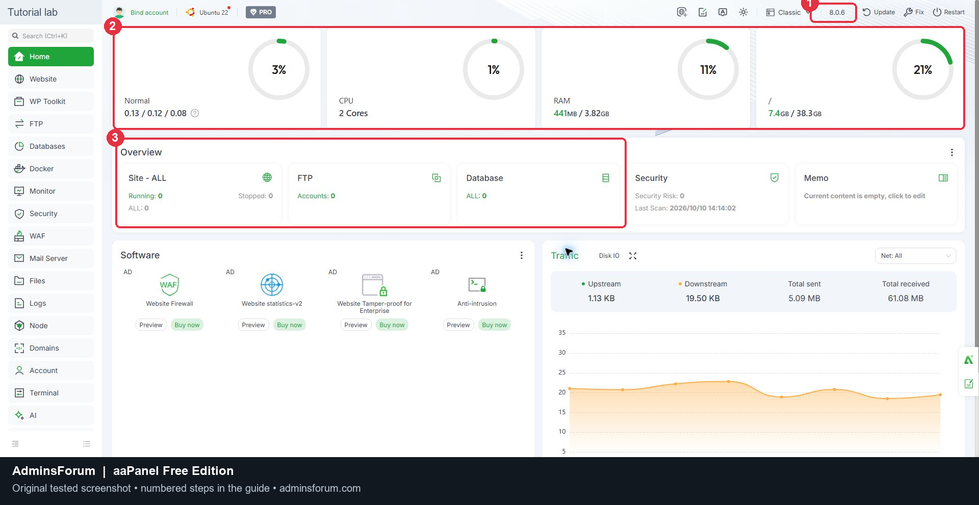

The opening screenshot highlights:
- The installed panel version: 8.0.6 in our test.
- Server load, CPU, RAM and disk information.
- Website, FTP and database counters. Zero counts are normal before creating your first site.
