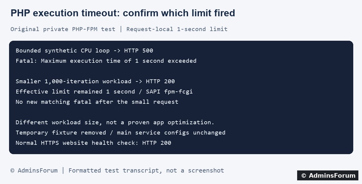

This guide reproduces the PHP error with a short, bounded synthetic CPU workload on a private endpoint. A smaller workload completes under the same request-local limit. It is a timeout demonstration, not a claim that we optimized or completed a real import.
Original AdminsForum private lab evidence, formatted as a transcript rather than a screenshot.

4. What our private lab demonstrated
We used the installed PHP-FPM service through a separate loopback-only Nginx endpoint. The fixture applied and verified a request-local one-second execution limit. Its longer branch also had an independent three-second wall-clock loop bound to avoid an unbounded test.
The disposable PHP file was removed, the private listener stopped and its PID file disappeared. Hash checks confirmed the main Nginx configuration, PHP-FPM pool configuration and php.ini were unchanged. The normal HTTPS website returned 200 afterward.
- The bounded synthetic CPU loop hit the PHP limit and returned 500. The log recorded the exact one-second maximum-execution fatal.
- A separate branch performed 1,000 small synthetic iterations and returned 200, reporting effective limit 1 and SAPI fpm-fcgi.
- The subsequent log section contained no new matching execution-time fatal.
