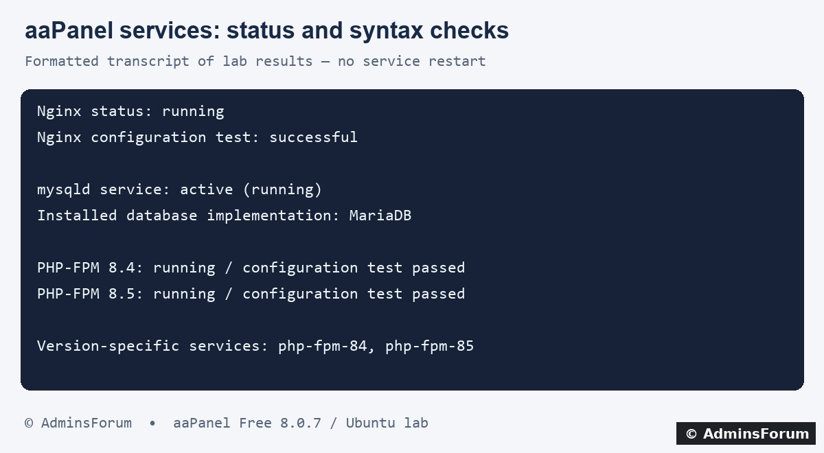

Tested lab: Ubuntu 22.04.5 and aaPanel Free 8.0.7. We checked Nginx, MariaDB under the mysqld service name, and PHP-FPM 8.4/8.5. Nginx and both PHP-FPM configuration tests passed. This lesson tested diagnostic commands without restarting those services.
Formatted transcript summarizing actual status and configuration-test results from our lab.

The lab's status reported Nginx running. The syntax test reported that /www/server/nginx/conf/nginx.conf was valid and the test was successful.

Confirm the PHP version selected for the website in aaPanel. Our lab has two separate services:
Both reported running. Version-specific configuration tests were:
Both passed. Use the matching path for your installed version. Restarting 8.4 will not repair a site served by 8.5.

Our status output identified MariaDB and active (running), despite the service script being named mysqld. Both naming and installed implementation matter when interpreting commands.

Nginx was running and passed its configuration test. MariaDB's mysqld service was active. Both PHP-FPM 8.4 and 8.5 were running and passed configuration tests. Service restart examples were explained, not executed or claimed as tested.
AdminsForum CLI series. The image is a formatted lab-result transcript; use the service names and paths actually installed on your own server.
