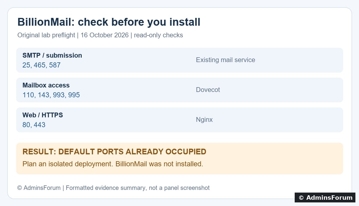

[Image: attachment.php?aid=365]
Formatted summary of our actual port checks, not a BillionMail dashboard screenshot. Existing mail and web services already occupy the relevant default ports.

ss -lntp
In the output, compare Local AddressTongueort with the deployment's published ports and note the process responsible. A listener on all addresses is different from a listener restricted to one address. Our exact local findings were:
  • 25, 465 and 587: existing mail-service master process.
  • 110, 143, 993 and 995: Dovecot.
  • 80 and 443: Nginx.
These are observations from our current aaPanel mail lab, not a fresh-server requirement checklist marked as passed. We retained the working services and stopped the installation plan at this point.
